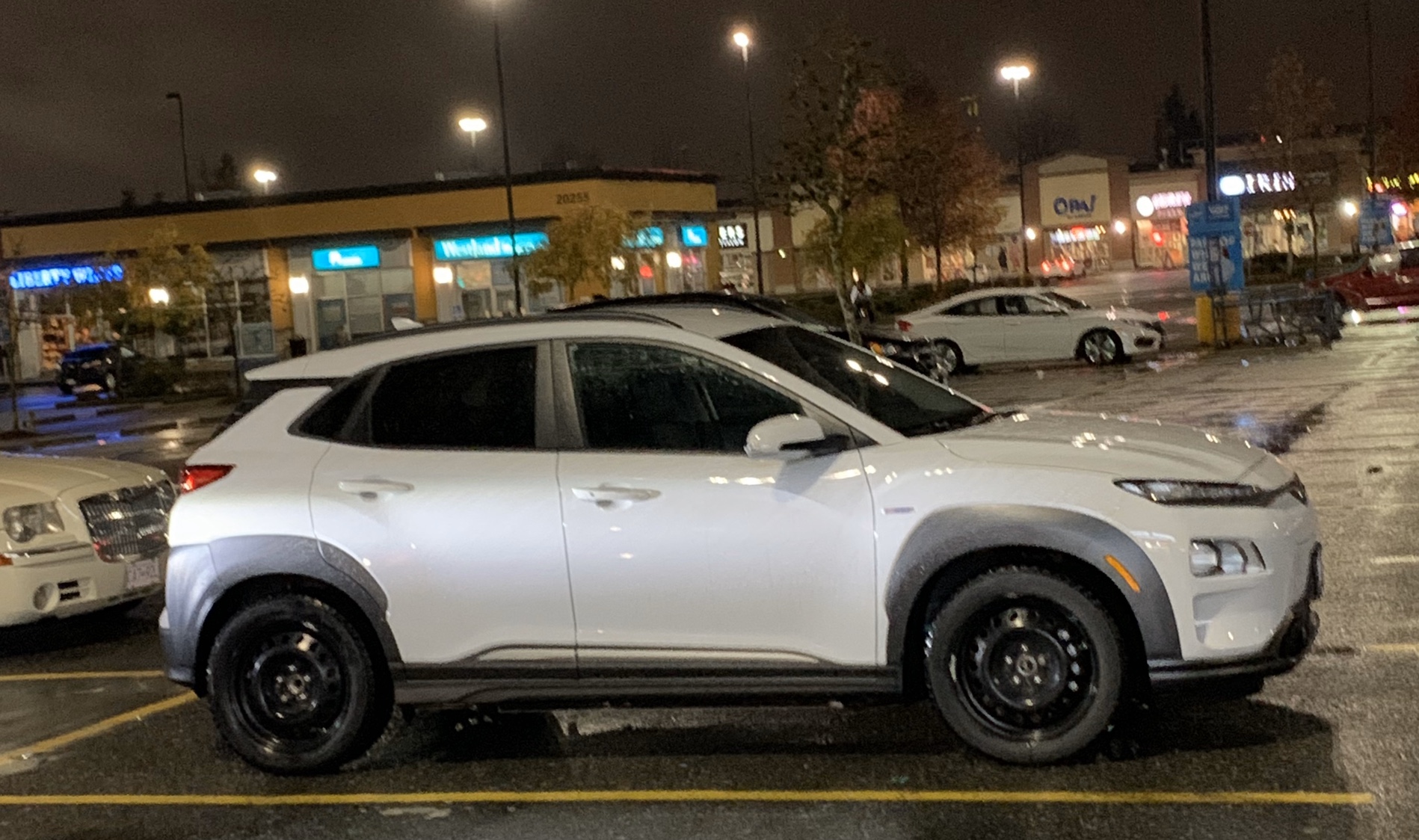

I got 17" steel wheels from Costco, about 50 or 60 Canadian each, and I got Michelin xice 3
I live in Montreal so we need good winter tires.

Blizzak WS90s weren't available in a compatible 16" size, so I ended up getting:
215/55R17 WS90s mounted on 17x6.5 ET50 steel wheels. (I did check that those Blizzaks were compatible with 6.5" wheels.) Not going to put them on right away, but can report back when I do.
OK! Finally put these on.
They fit! I am *very* glad I went with the 17" wheels. The front brakes are huge and I don't know whether this style 16" wheel would've fit.
I did absolutely nothing for TPMS reprogramming. I ordered the wheels and tires pre-mounted with TPMS from Tirerack, put them on and drove a bit and the new sensor values came up. Much easier than my other cars have been.
I can't tell a huge difference in noise or performance (yet). I can still spin the tires from a stop :-P

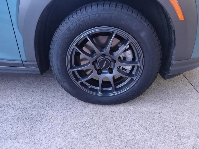

Probably just splitting hairs at that point IMO. I went with 16's for my car, each rim/rubber combo is 9lbs lighter than the stock wheels. 12-15 lbs lighter than 17" steelies perhaps?
View attachment 6610 View attachment 6610
If range is critical, then I would say spend the extra on lighter rims and maybe 16" since they seem to work. I remember an earlier post where someone said 16" rims rubbed against the brakes (if I remember correctly), and that concerned me so I went with the same 17" as the oem. I did however get steel rims. I'm sure it's a combination of the colder temperatures (I'm in southern Ontario), the heavier steel rims and the 17" winter tires (Blizzak WS90), but my efficiency has plummeted! I was averaging around 12-14 kWh/100km in the summer on the Nexens. Now I'm getting 18-21 kWh/100km! However, range isn't critical for me, and I'd much rather feel secure driving in winter around here. We're in a snowbelt so that was my priority.

It's really hard to tell. You have 9 lbs more rotating mass than me for each wheel and a bigger contact patch which should result in more friction. On the other hand, your wheels have less wind resistance.
