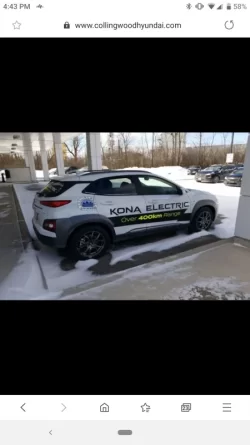

I finally got my dealer to try on 16 inch rims on my Kona EV.
Short answer : they don't fit.
Long answer : the 16 inch rim fits, as in it can be put in place fully. But once it's on there and you try rotating the wheel, you can feel it gently scraping against the brakes. You really don't want that to happen on the road. It's really a question of a fraction of an inch. So we have to stick with 17 inch rims.

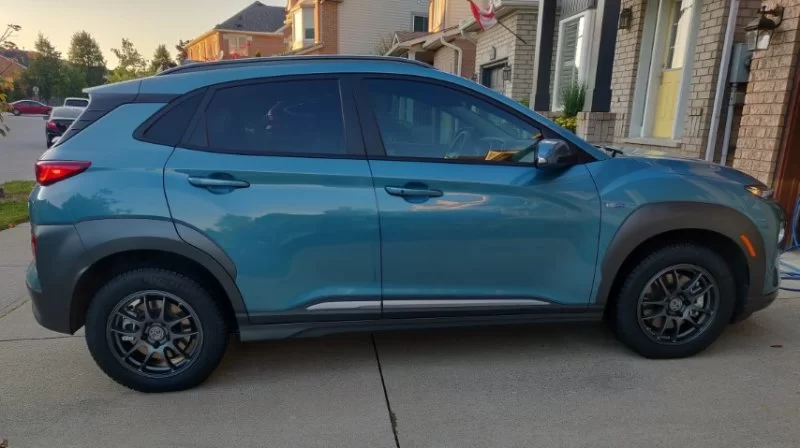

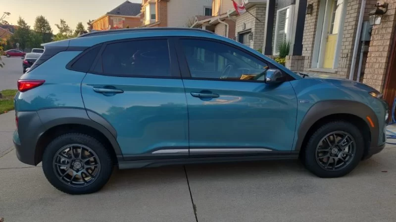

Test fit my new 16" rims with Michelin X-Ice xi3's on them last night. I'm good to go for a few winters now. They're not as aero looking as the factory rims, but each rim/rubber weighs 9 pounds less than the factory set so that should compensate a lot.

So glad it worked!! I plan to get those same tires. Do you mind sharing the details of the 16”? I had one test fit yesterday and it didn’t fit on the rear wheel so I thought I needed to go with 17”. I don’t know the specifics of the 16 my guy tried. He did say there are variations of 16s. I read through this forum and saw someone else had a 16” fail so I was going to give up. I’d love any advice! (I’m in the US if it matters and also have ceramic blue!!).

These are the wheels I bought:
https://pmctire.com/en/wheels/rssw/...mat-16x6-5-5x114-3-deport-offset-40-67-1.tire
They're a 16 x 6.5 wheel, 5 x 114.3 bolt pattern, 67.1 center bore and a 40 mm offset.
I also test fit these rims and they also fit:
https://pmctire.com/en/wheels/rwc/m...anthracite-16x6-5-5x114-3-67-1-deport-40.tire
There's not a ton of extra clearance with either, so I could see how some 16's won't fit. But I know for a fact that the above two do fit, which means a bunch of others should too.
