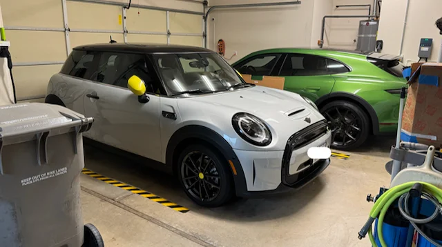

Have been going to Physical Therapy for my lower back and it is feeling much better - so I finally had the chance to wash the SE. Smaller than the Cross Turismo, but somehow takes the same amount of time to wash each car. Washed in the garage using Optimum No Rinse and two bucket method.

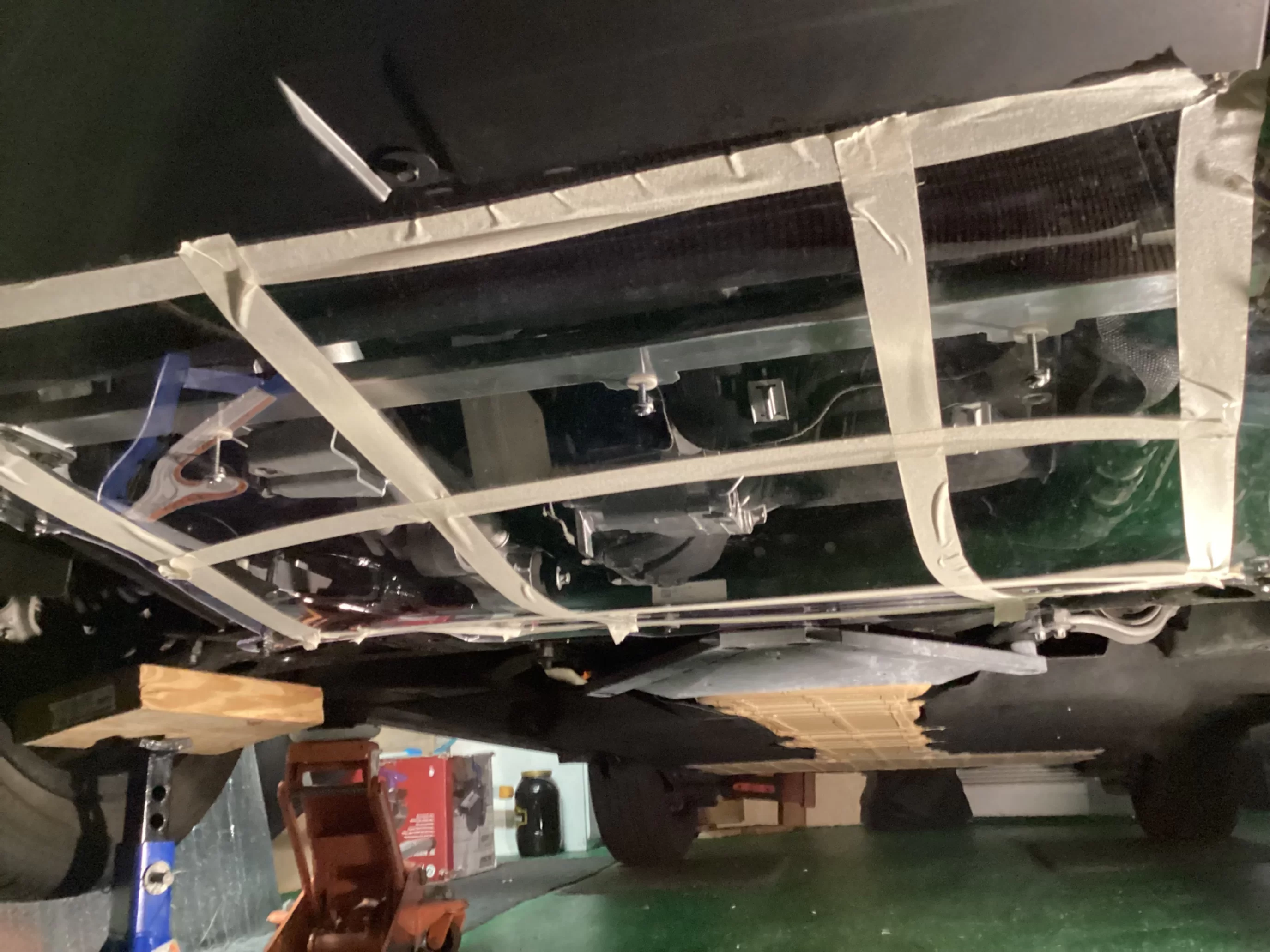

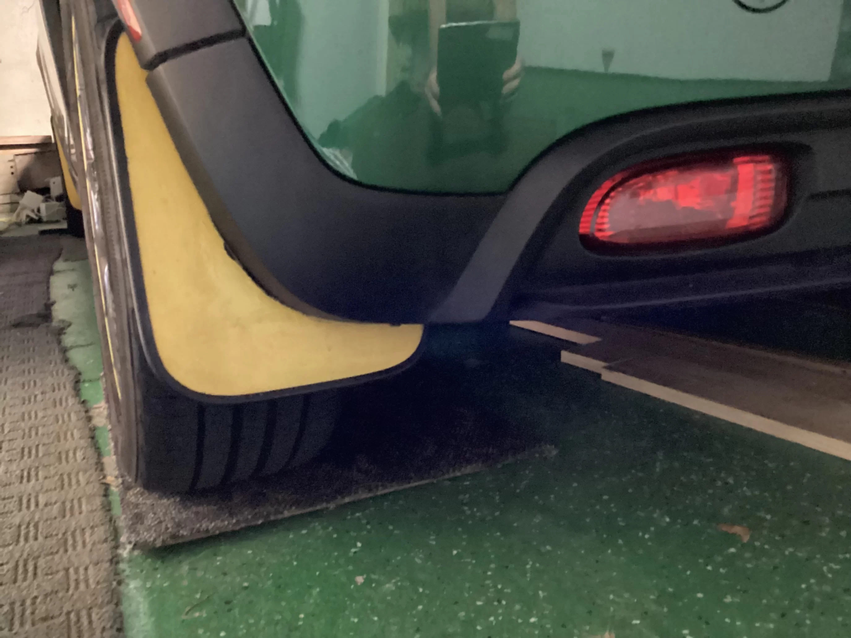

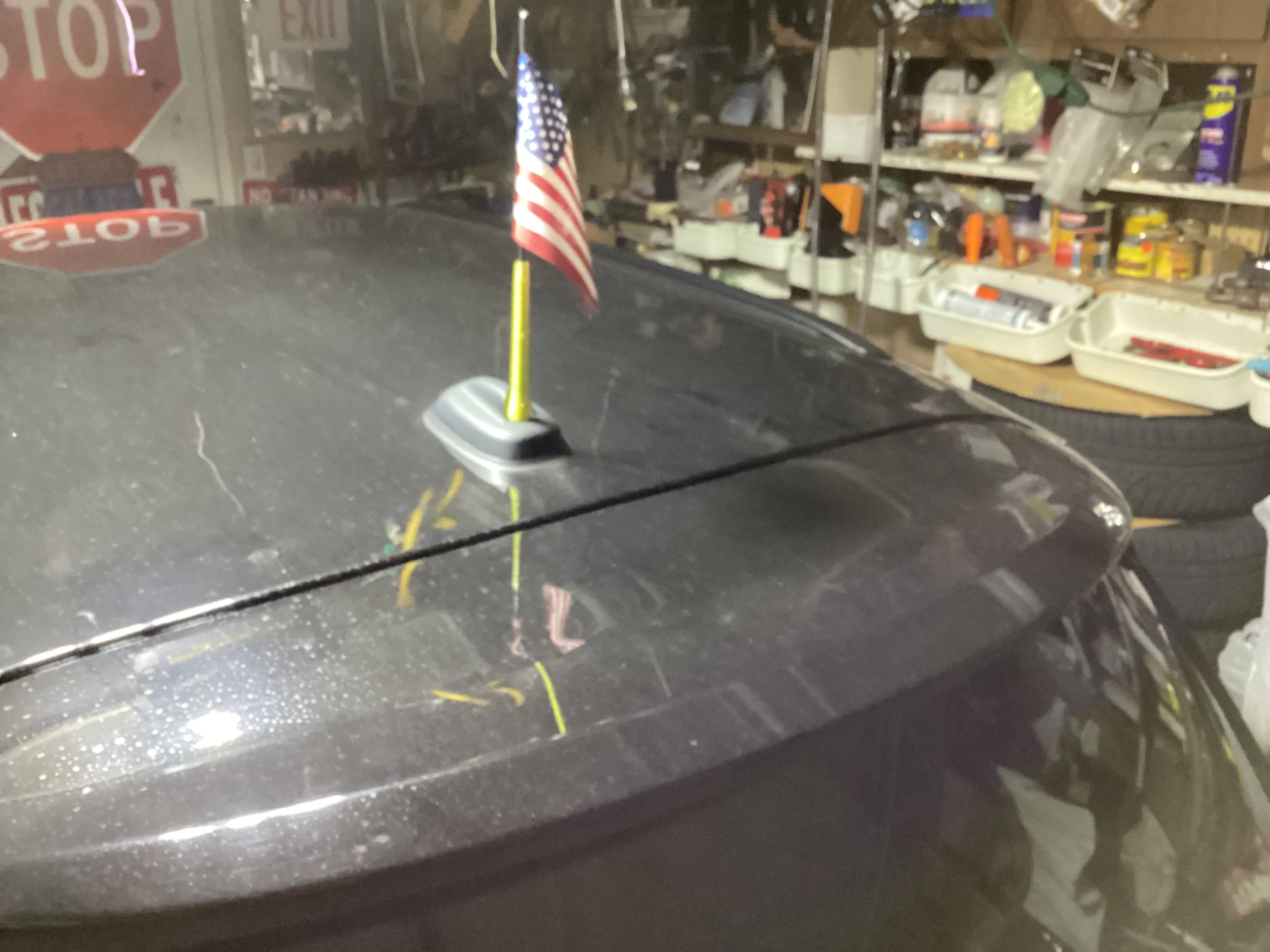

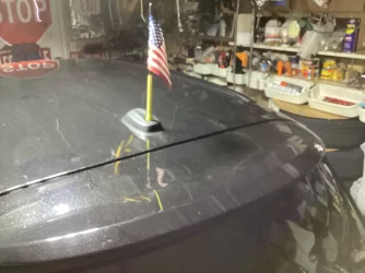

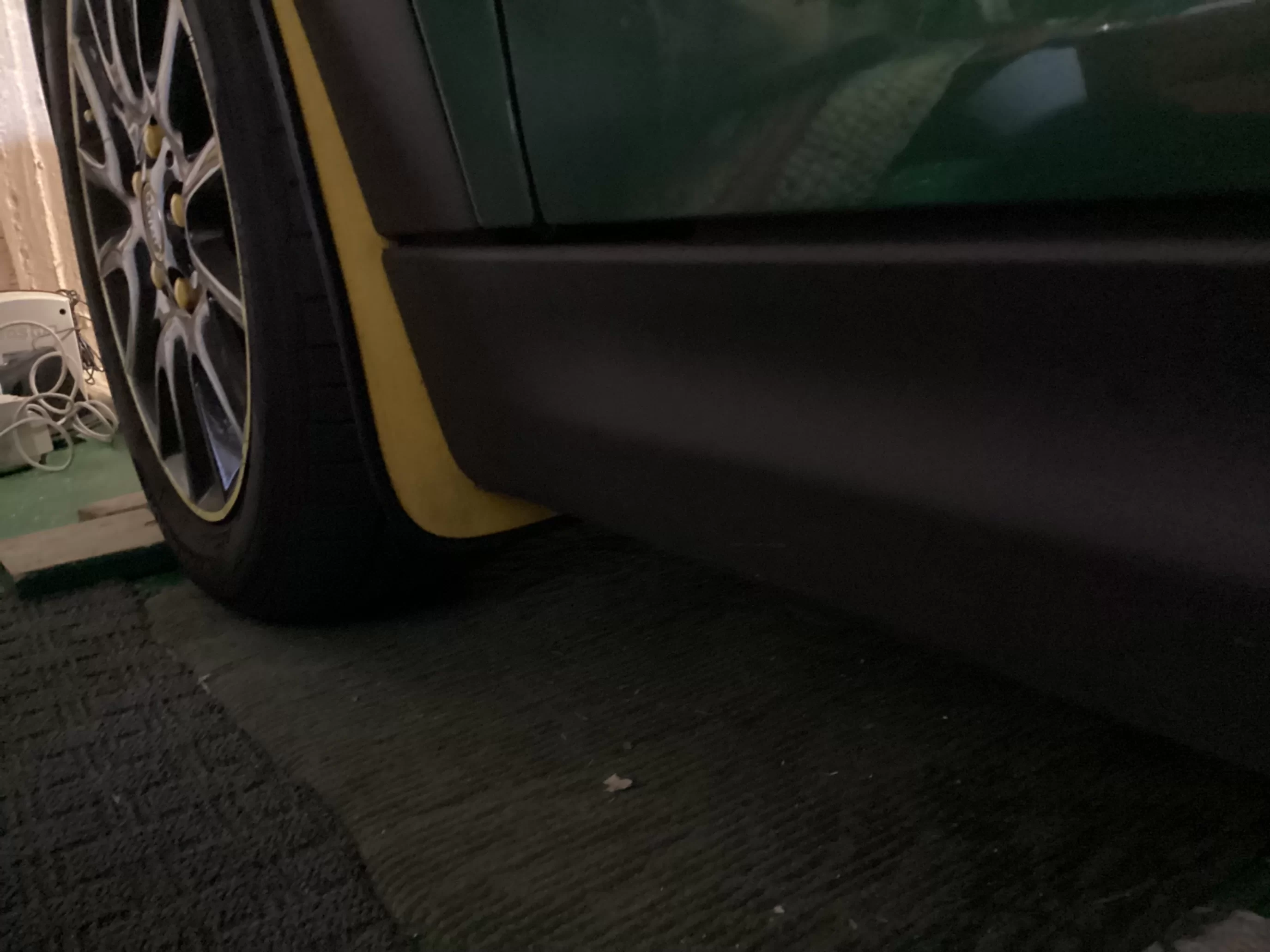

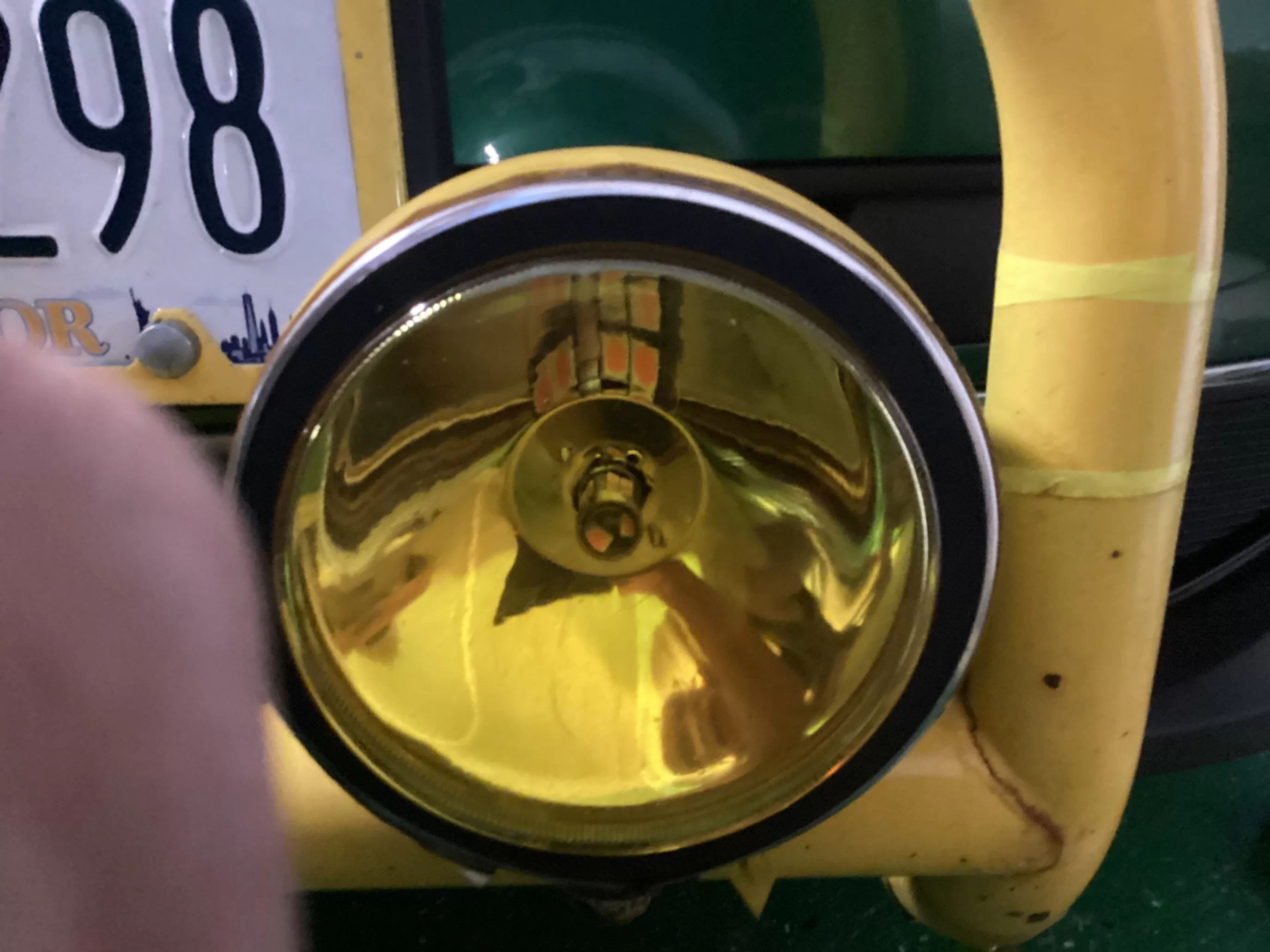

What keep my back hatch quite clean are oversized mad flaps ,smooth lexan protection under a front of the car for better air flow and bull bar with 6” lights which deflect air flow different directions and 4x6” American flag on antenna creates vortex which in specific speeds is quite noisy and I believe a washing weekly a dust from using a regen all the time helps a little too .And the most important is hit 92 miles/hr to push a dust/ dirt of SE daily! As I would love hit 150M/hr but this is Max for Mini .Shield under a car shows masking tape bc is clear you will see like nothing is there

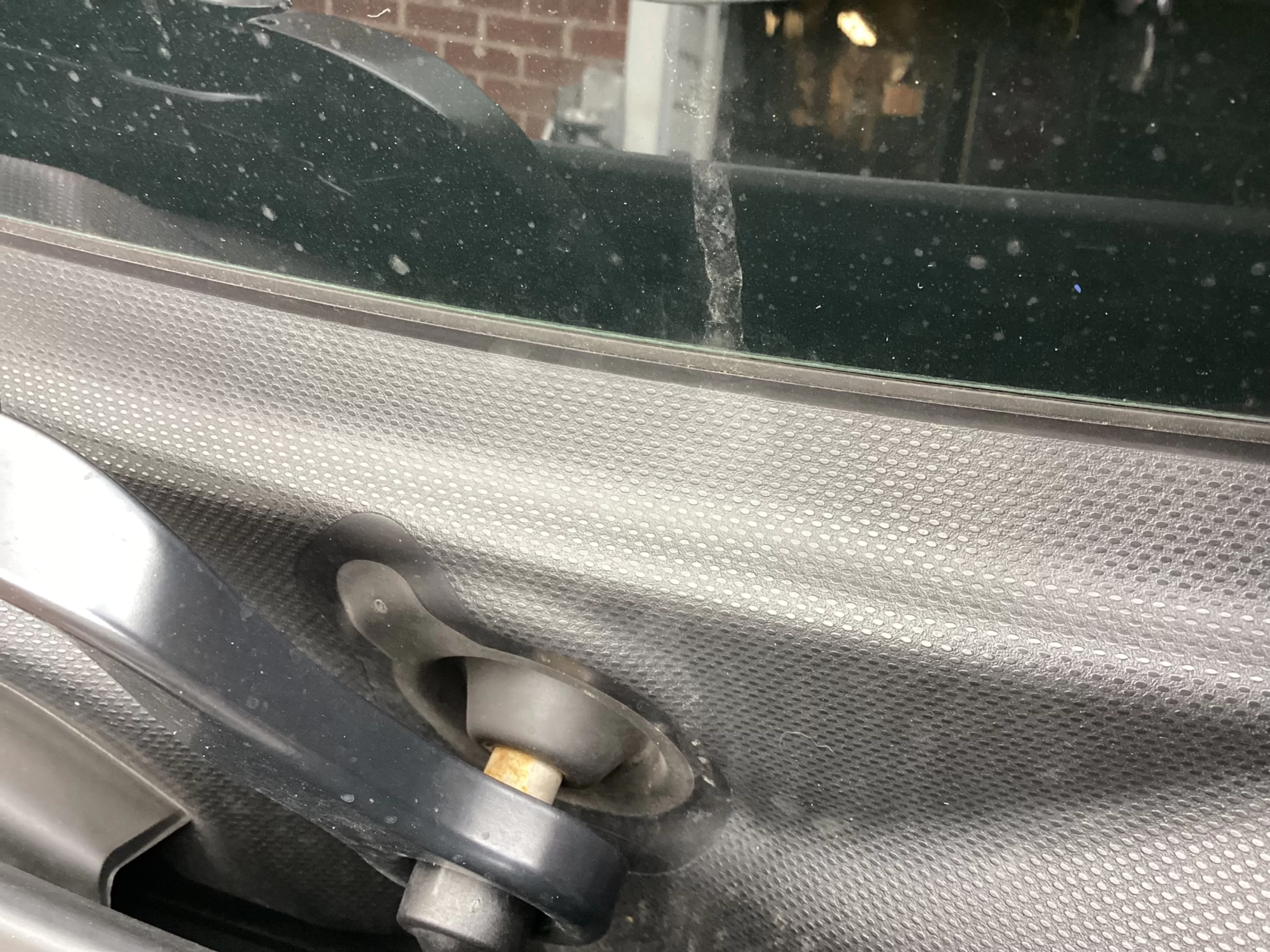

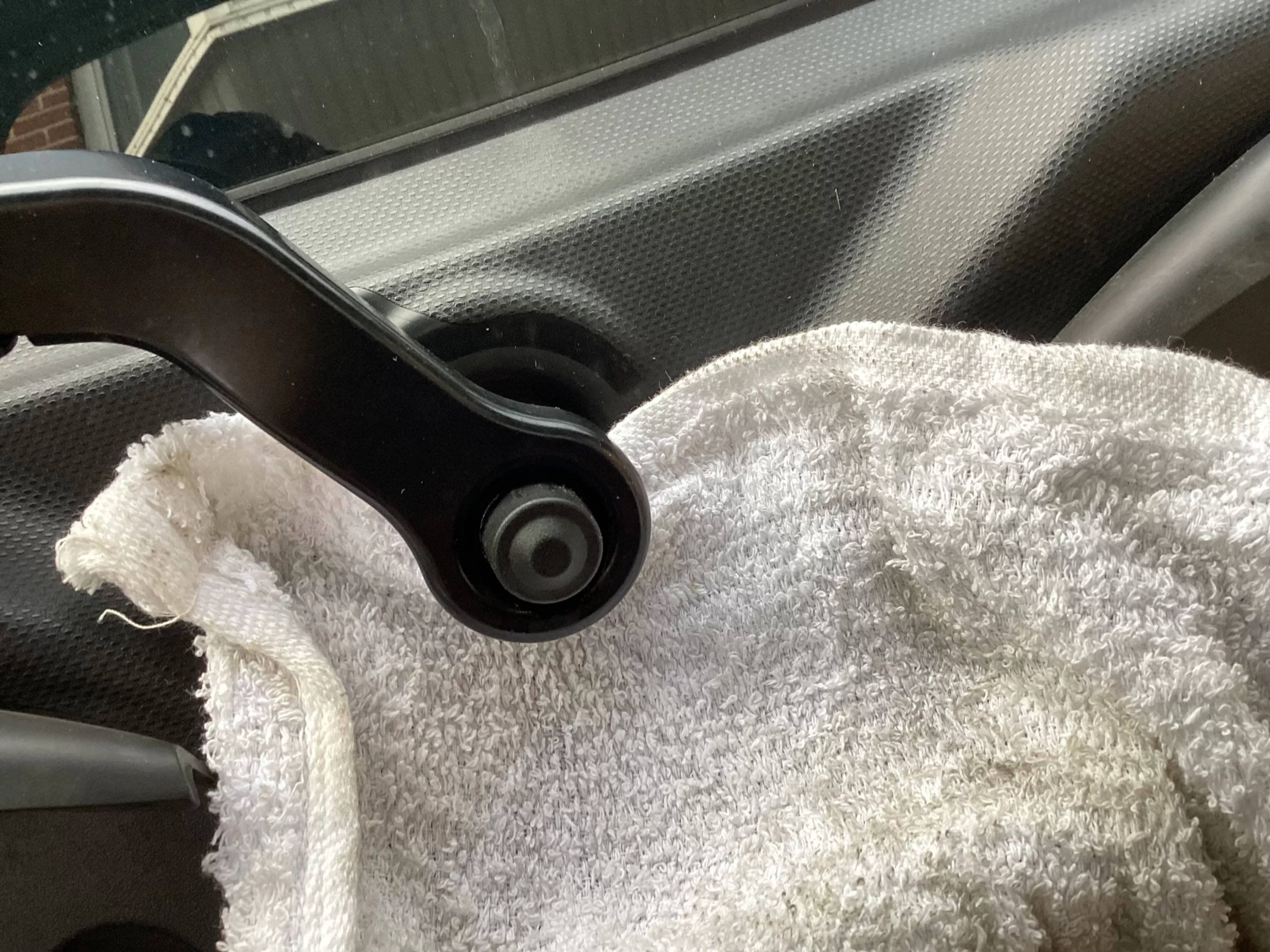

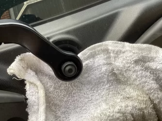

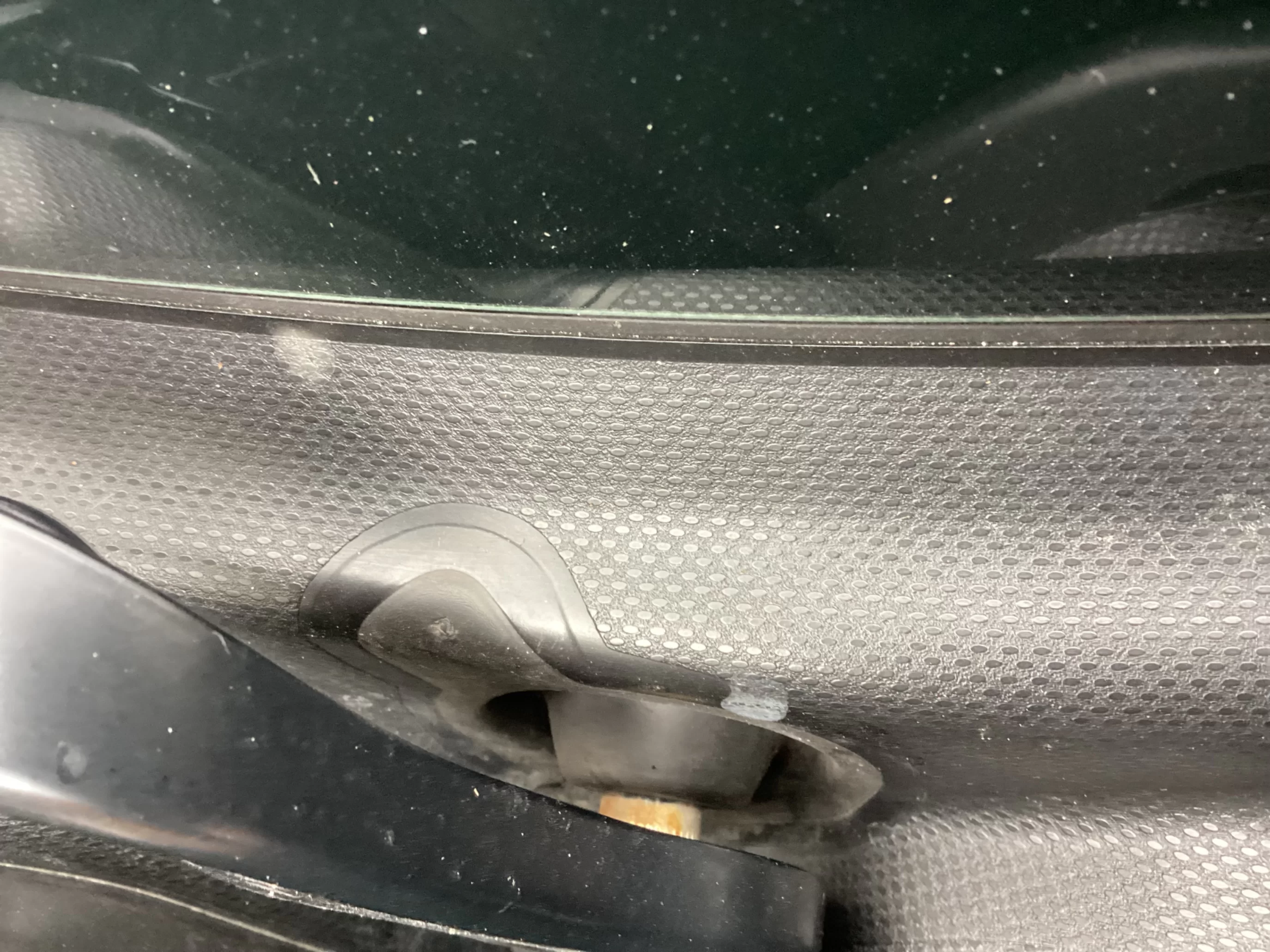

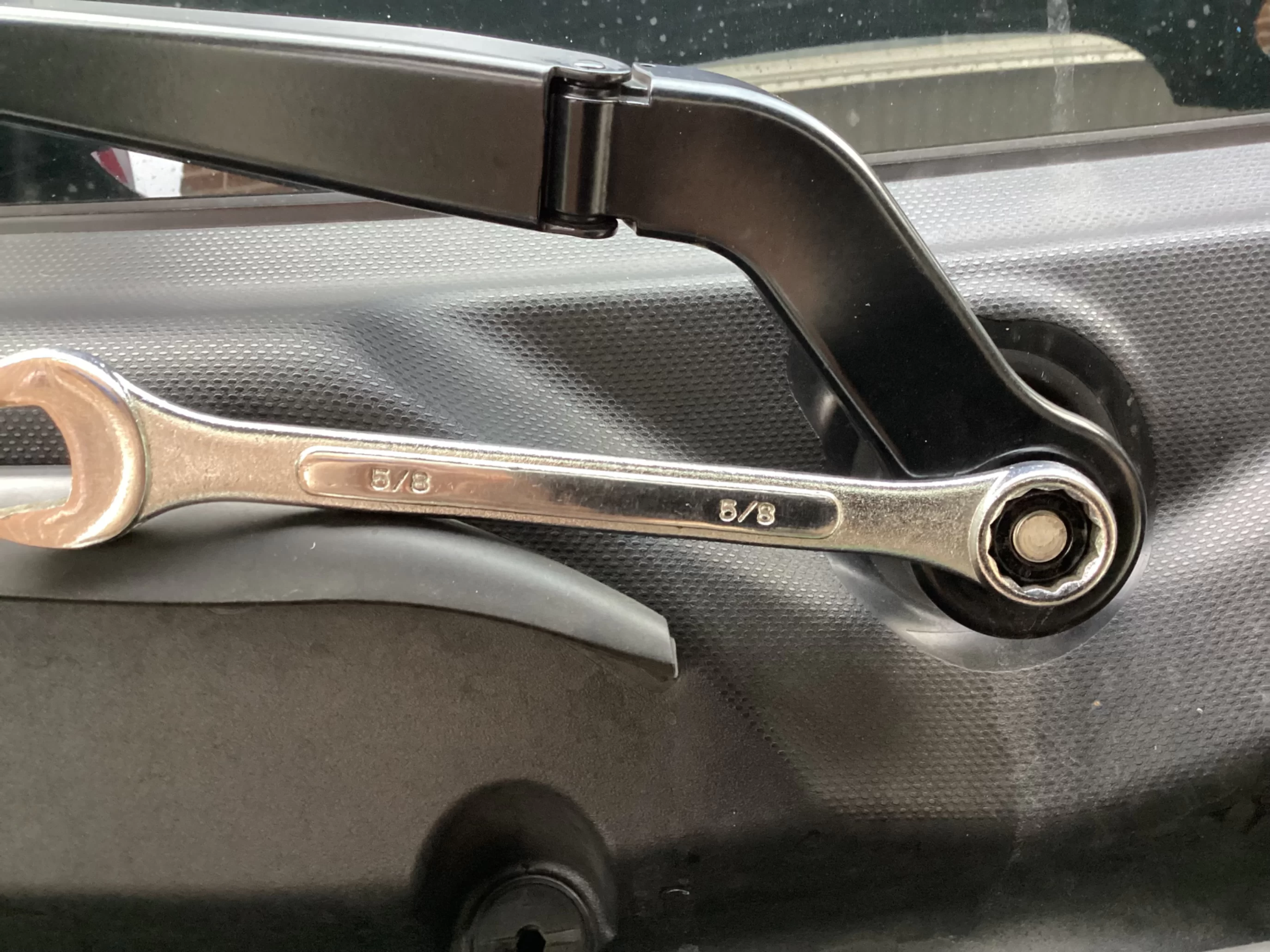

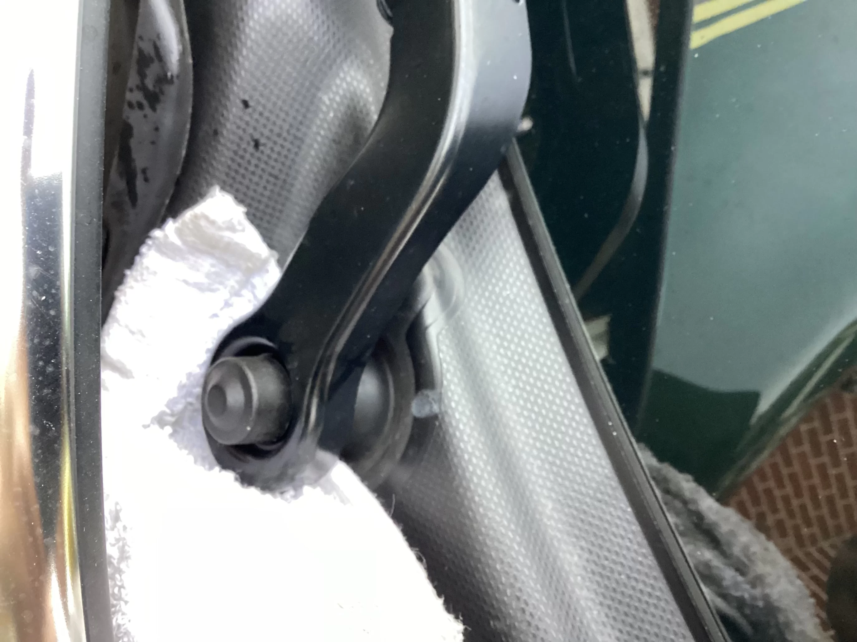

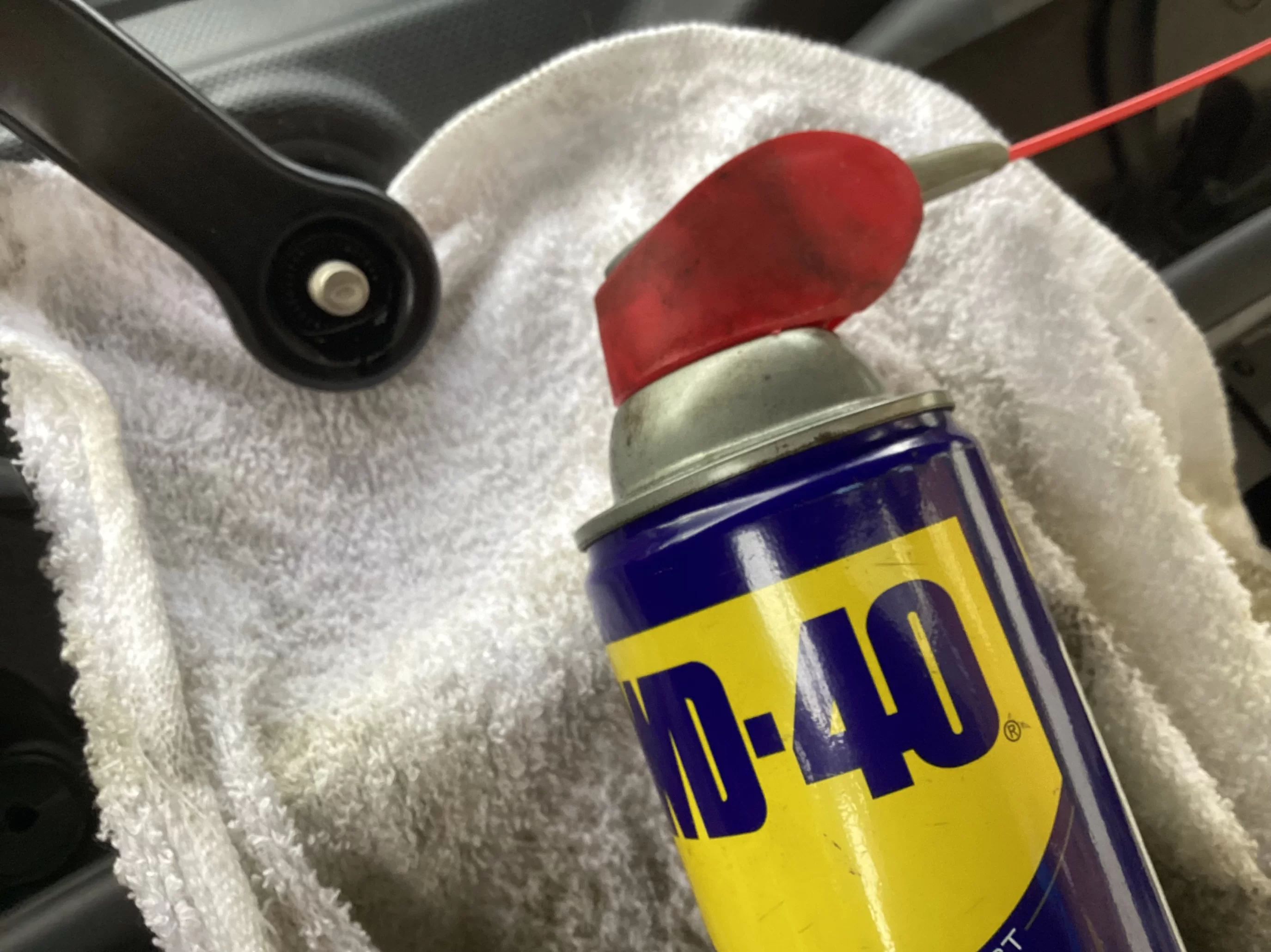

As I was cleaning a windshield from NY pollution I noticed a shaft from motor to arm of wiper get rusty what I did I cover that part with silicone grease and take of plastic cover from nut and nut holding a wiper arm than I spray with WD-40 and put back .As I’m not assuming I need to replace arm soon I thing help in a future to as I’m going to drive my SE to ground as 75 yrs old . That could be expensive fix if arm fuse from rust and is stack
