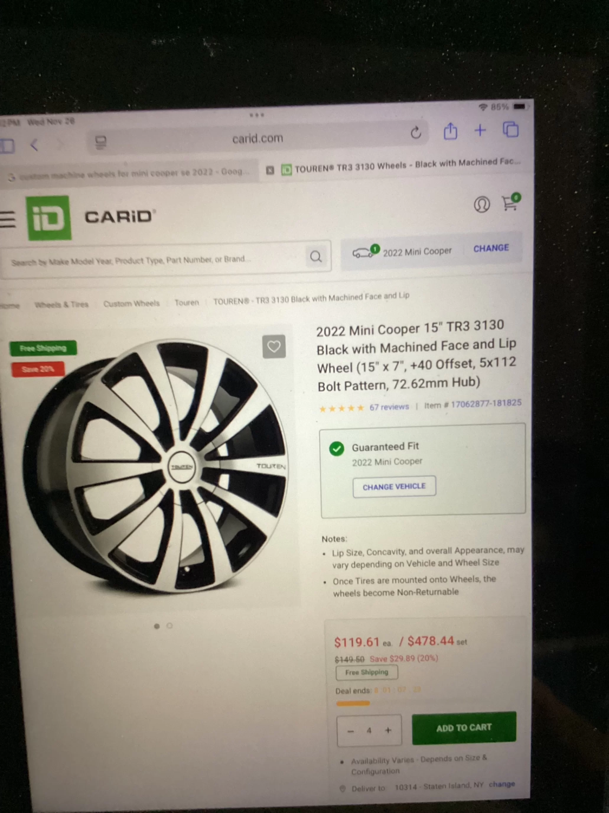

I think the offset of my 15" rims is +28. If I find some adapters that are 20 mm, it should put me back to stock. And the rims are supposedly made to accommodate bigger calipers so I'm hoping they'll fit. We'll see once I wear through my new tires in a year or so, and I switch to the 15" wheels.
Adapters/spacers reduce the offset. You'd end up at 8mm.
Got it, thanks. I should drill new holes.
What about to use wheels adapters these bolt onto your cars existing hub pattern and provide a different set of studs for 15” wheels which I belive is a safest most common alternative. Those 15” wheels should fit SE

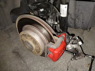

Test fitted a rear caliper and bracket combo. It's a cable type caliper, but since it looks like it will work, the plan is to strip a pair down, weld and machine and swap parts to get them motorised. This will fix the lack of clearance to 15" wheels. Caliper is 36mm instead of the stock 34mm. My brakes were somewhat heavy with 245/35 sticky tyres, so this is a good upgrade. Not sure on front calipers, yet. Could be aluminium Prius, e90, Malibu or some 4 pots. The 4 pots are 3kg lighter, each, than the stock f56 ones, which is very tempting.

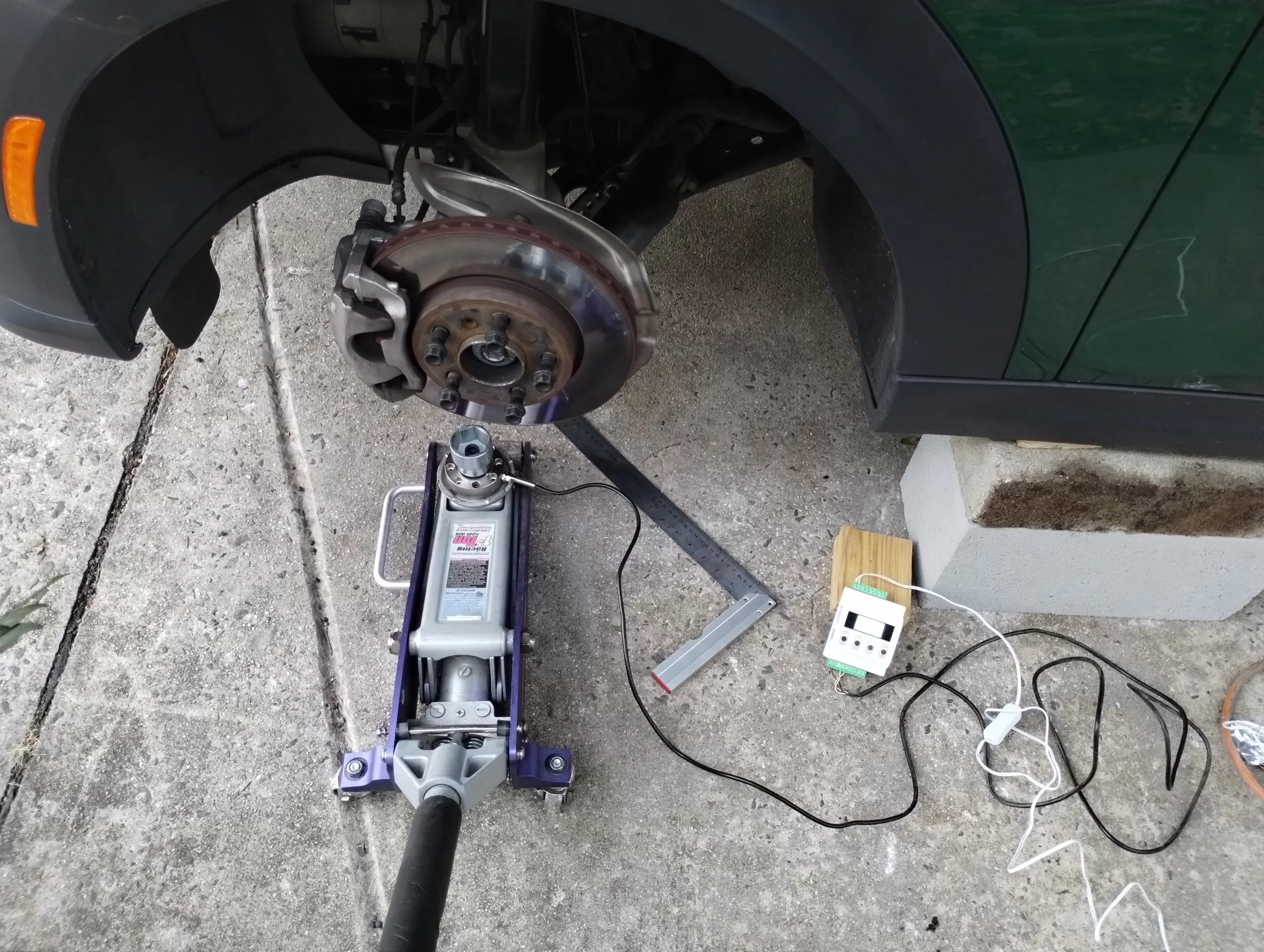

More measurements of a ghetto racer sitting on concrete blocks. Between the jack and 50mm socket is a load cell. The socket engages the bottom balljoint well enough to stay there. I just did an on car measurement of front spring and anti roll bar stiffnesses.
Spring: 37.5 N/mm about 5% stiffer than a way cruder measurement I did last year with concrete blocks balanced over the drive system.
Antiroll bar comes out as 13.6N/mm stock, or 19.1N/mm in my '+40%' hole. I love it when things measure that close to theory. I was surprised at how soft the ARB is. It certainly felt more of a step when I added holes. It measures as making the front 10% stiffer in roll.
When I get my struts made, I have some 51N/mm M3CS springs to go on. I'll probably want to upgrade the ARB at some point, too. But one more hole to around +50% will do for now.
Tomorrow I'll see if I can do a similar trick on the back. I've already measured the spring, but I'm dubious about my motion ratios.

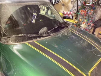

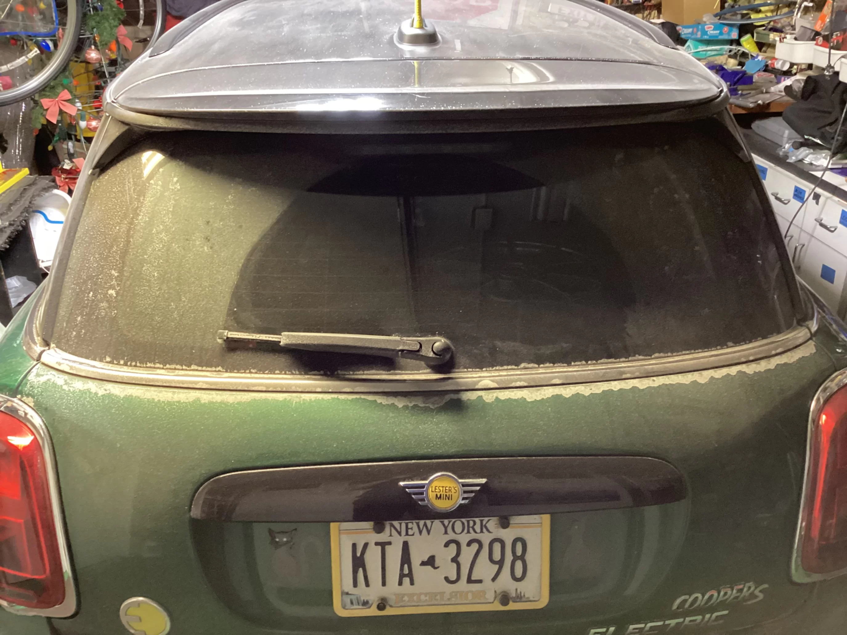

As I’m seeing cars so clean in this tread I would love to show my Rexsio as freezing weather not aloud me to wash my car as in NY and every highway around is white from salt .
