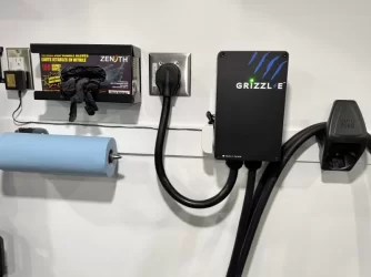

Today I finally modified my Grizzl-e EVSE to enable control by my home automation system.
Hat-tip to @pictsidhe for pointing me in the right direction earlier in this thread (more than two years ago!). A while back I found a post in the Ioniq 5 subreddit discussing just such a mod to the Grizzl-e Classic, but pursuing a different home automation goal. In my case, I don't need a way to control the EVSE for a specific charging time window, but rather to disable charging when the outside temperature drops below a certain threshold.
Because I heat with a heat pump backed up by a natural gas furnace, I'm on a dual rate plan with my electric utility. Electricity costs 6¢/kWh (Canadian, taxes and fees included) most of the time, which is about 25% cheaper than the standard rate. Because most of Quebec heats with electricity, when the outside temperature drops below -12°C, to reduce demand, dual rate customers are switched to the backup heat source (furnace) and the electricity rate rockets to 40¢/kWh.
I already use a system of sensors and relays to limit the use of my 5000 W garage heater when it gets that cold, so I wanted to be able to disable charging my car without having to pay attention to the temperature and intervene manually.

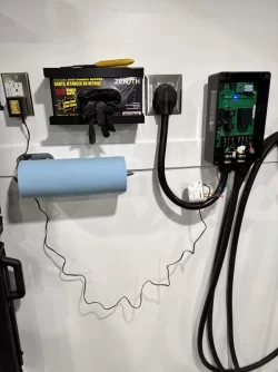

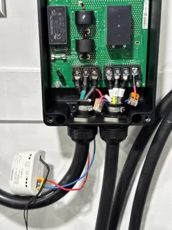

Using the Reddit post as a guide, I found a Zigbee version of the same Chinese offbrand relay. I opened up the Grizzl-e and tried to find a source of 12V DC to feed the smart relay, with no luck. The same two pads on my v.2 Grizzl-e Smart's upgraded wifi board don't supply 12V, and I didn't want to poke around any further, so I found an old DC wall wart in a junk box and decided to put it to use. I was also wary of putting a ZigBee radio inside the EVSE's beefy aluminum enclosure and getting a reliable signal, so I decided to drill a 5 mm hole out the back of the case and mount the relay outside.
So far I've done a few tests using the Hubitat app to switch the EVSE on and off, and written two very simple routine pistons that will control it according to the temperature. At this point, it does indeed prevent or interrupt charging, but when the relay closes again, the EVSE returns to the ready ("vehicle detected") state but charging does not resume. I'm not really sure why. I've packed it in for today, but tomorrow I will test if there is some sort of countdown timer in the car when resuming after an interruption. I might also test it without the resistor.
Does anybody know if the SE is supposed to resume charging after an interruption? I thought that was default behavior. More testing in the morning.
Ok started testing again. Still no luck.
I plugged the car in and initiated a charge this morning without issue. After a few minutes (charge notched up from 25% to 26%), I used Hubitat to open the pilot wire, which deenergizes the EVSE's hot leads. The EVSE's indicator light went from flashing green ("Charging in progress") to solid green ("Charging complete or no current consumed by the car"), and the IC went from animated yellow to orange, "Calculating," and displaying the little clock icon for "charge in time slot" even though it's set to "charge immediately." I let it sit for 10 minutes, then closed the relay again. The EVSE light went to flashing blue ("Vehicle detected"), while the car's IC remained dark (it turned off after some time not charging). I went in the house and let it sit for an hour, and I just checked the MINI app and it still shows "initializing." I returned to the car and the light at the charge port is off; I unplugged from the car, the EVSE light returned to steady blue ("Ready"), and I'm letting it sit for a while.

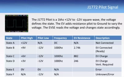

Next step will be to remove the 2K resistor from the relay circuit. That would have the effect of returning the car to State A ("not connected") instead of State B ("EV Connected (Ready)"). The car will still know it's connected, from the proximity sensor.

It was my understanding that you need to address both Control Pilot and Proximity Pilot.
That chart you attached is for the Control Pilot, so if you are relaying the Proximity Pilot then swap to CP before doing both?

Of course, we had a wind storm, and then my garage door broke and got stuck halfway open, so I spent most of my afternoon working on that to at least get it to close before the temperature plummeted last night. When I awoke, it was indeed already below the -12°C threshold, and my poor car was stuck outdoors overnight as I awaited the arrival of a trained garage door technician. No test.
The technician has been and gone, I got my car back in the garage and plugged it in, and it began charging immediately, so something is wrong with the syntax of my routine pistons, as the relay should have opened and prevented charging. I once again used the app to open the relay, and once the outdoor temperature went above -11.9° it should have closed again, but it did not. I've gone over my code and made a couple of changes, but now I have to wait for the next time the temperature drops. in the meantime I will do a couple of experiments with and without the 2K resistor. Something tells me that without the 2K resistor, the car will behave as if the handle were removed from the port, in spite of the proximity circuit. Fingers crossed.

Been testing the EVSE mod with the 2K resistor taken out of the equation. No real change. Without removing the handle from the car (or modifying the proximity circuit to fool the car), the charge won't resume once the car goes back to sleep. Still, this mod will come in handy for 90% of what I need it to do. It will either prevent a charge from initiating when it is colder than the threshold, or interrupt a charge when the temperature drops and the electricity rate changes. I will just need to remain mindful of the possibility of a charge interruption if I need a full battery before I set out.
