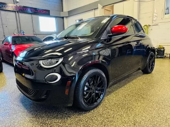

Well for now I got the winter setup on the 500e

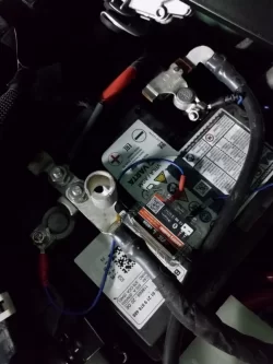

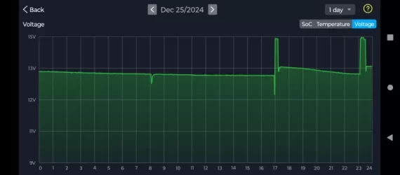

Fitted a Bluetooth 12V battery monitor. I'd like my fail to charge issue fixed before the warranty run out in July... When it doesn't AC charge, it is a timed charge, and I usually get a 'battery is discharging' warning. These are, however, not logged by the car. When the dealer was looking for electrical issues, it threw one while it was parked overnight in the service bay, so they at least now believe they happen for no apparent reason. The logger is an Ancel BM200. $15 delivered from AliExpress. They have several versions, this one stores measurements every two minutes and uploads to a phone via Bluetooth when in range, which is not very far. Works with phone in my hand inside the car and outside near the battery, good enough. Positive is easy to connect, I just put it under the clamp bolt. The negative side that doesn't really work, so I mangled it with with pliers then put it in the open parts of the clamp under the bolt, where it would normally be loose. It's important to go directly to the battery. You are supposed to deactivate the HV battery before removing the 12V, so I left the clamps on to mess with it...
I'm seeing blips at a scheduled 8:05am departure time, even though departure precondition is currently off for Xmas holiday? No inexplicable big dips yet that might trigger a battery discharging alert. But since it logs continuously every 2 minutes, it should catch any. Data is exportable as .xls, though I can't just download it, so I email it to myself.

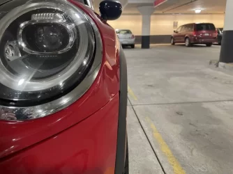

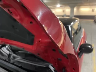

Not so much what did I do to my Mini today but rather what some rat bast@&$ did to my Mini at our local mall, offering me some unwanted bodywork mods. Sadly he or she forgot to leave a note so I could thank them…
Check with your insurance company, most companies will waive the deductible for hit-and-run damage on policies with full coverage. My hood got damaged in a Home Depot parking lot two months into my ownership, and the BMW-authorized body shop billed my insurance company $3600 to remove and repaint the entire bonnet, and replace all the plastic trim pieces because the clips generally break when removed.
Will do - thanks. Wasn’t aware of the deductible waiver. Estimates so far range from hood replacement, painting etc for $4500 down to Paintless Dent Removal at $1600 with the caveat that because the edge of the hood has been crushed, that part likely can’t be massaged out.

Frankly I was shocked at the PDR estimate. There’s multiple openings inside the hood (er, bonnet…) support structure that provided access to most of the damaged skin so was expecting $300-500, not triple the high side. I concede it is an art and requires skill and time to do well.
