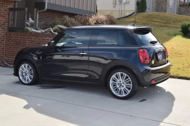

Tinted Miriam with Xpel Prime XR+ 35 (everything except windshield), tinted side markers and added Xpel Ultimate Fusion PPF to the top of the rear bumper.

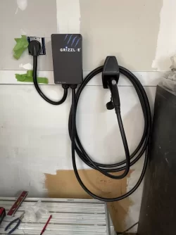

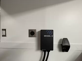

Not specifically the car, but for it: I got around to finishing the part of the wall where the EVSE is mounted. I am a pretty terrible carpenter, and tend to be lousy at mudding, but this is in my cluttered garage so I’m able to just keep practicing. :cool: A '60s house with shoddy 2x4 construction and poorly-installed, paper-faced fibreglass insulation above the visible board, one inch of expanded styrofoam on the foundation wall below. A while ago I tore out the drywall above the board and added 2x2s to the studs, and replaced the crappy batts with fresh 5½” Rockwool, VBL, then new drywall and the (dreaded) mud. Today I finally finished painting, installed the receptacles, and reinstalled the EVSE. Looks cleaner, and the added 15 and 20 Amp receptacles on that wall (most not pictured) are a bonus.

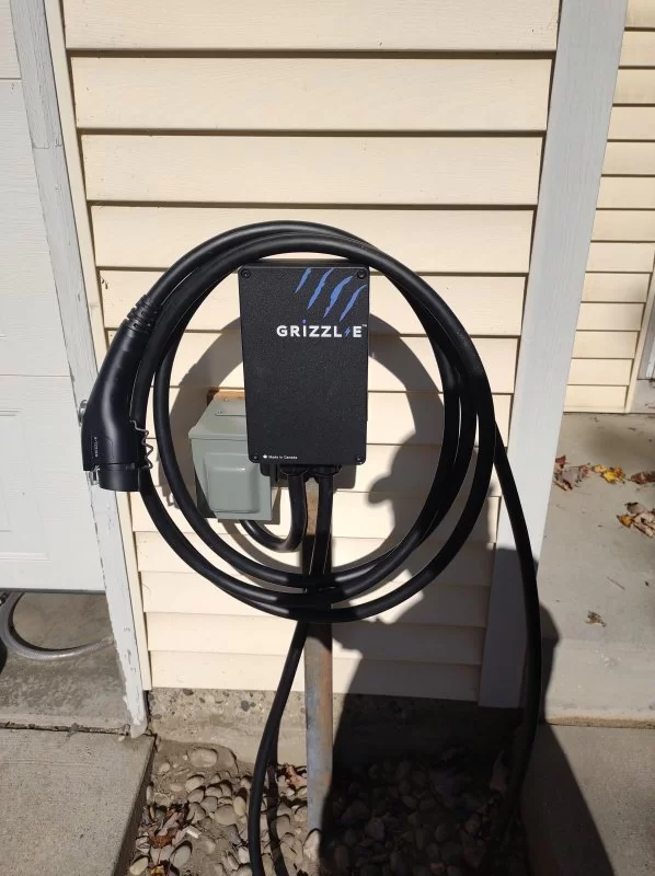

Just wish I would have did it earlier so I could paint the post. But that will have to wait till next summer. I'm in Michigan so we'll see how will it holds up. Don't know if I really want to open this one up yet.
