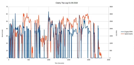

We came home a couple days ago with zero range left on EV. Instead of charging, I decided to go out for a drive today with the sole intention of summoning the bees, and recording what the engine RPM's were doing. I drove around for about 45 minutes, some highway speeds, and some stop and go with lights. I was up and down hills accelerating aggressively. I tried as @Dustin suggested and stopped at the bottom of a hill, engaged HV-Charge, then floored it up the hill...
Bottom line, I never experienced the Angry Bees (at least, not that I recognized).
Here is the trip log with speed, and engine RPM's. The highest RPM's experienced throughout this exercise was 3177:
Another slightly smaller peak at ~200 seconds of 3052. As before, the ICE seemed happy to run at an average of maybe 2000 when it was on. The 'high' RPM peaks were very brief - no sustained high RPM's.
I am not going to waste more time trying to invoke a condition that I may never experience with my normal driving patterns. I assume at some point I will experience the bees (maybe when I least expect them)... I was just trying to help answer some unanswered questions so we could all have a better understand our cars.
If someone can identify a foolproof way to insure getting the Bees, I would be happy to try it and gather some data in the process. At this point, it just seems like I am wasting my time trying to cause this behavior.

Thank you for the data. It is very informative. I think with this workload this engine should last 300k miles. I am glad Honda went with a port-injected engine design, so no carbon buildup issue anticipated.

Thanks very much MrFixit for providing your graphs. Very interesting information. I also hope that someone can come up with an app that can provide us with more information on the Clarity via an OBDII. I have a Nissan Leaf, and somebody developed the LeafSpy app that shows a great deal of information about the car, mostly centering on battery usage and health.
Thanks for the data and the charts. The charts show exactly why it is currently impossible to compute an mpg with this car. You can get a macro view of gallons used over a given distance but the truth is the car switches often between EV / Regen / ICE running and that creates a mix. The battery is charged by the ICE, being plugged into AC, and through regen. Further as you indicated the ICE isn't connected to the wheels in your chart; its generating electricity. Even if I could record miles traveled only while the ICE was actually running I'm not sure what good that data would be.
