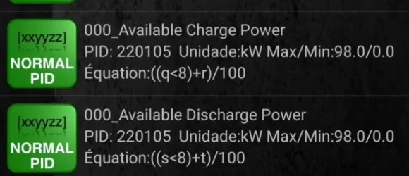

I have noticed a couple of things since the BMS update.
First: It doesn't show Max Power & Max Regen in Torque, or the purpose-built, dash-mounted OBDII device anymore (I assume along with current power and regen...couldn't really look at my phone while driving for obvious reasons).

Max Power & Max Regen are still available but you need to update the PID and the bytes in the Torque Pro. Thoses values haves always been available on 2 different PIDs: 220101 and 220105. The values on 220101 have been replaced by something else with the BMS software update but they are stiil available on 220105. For the Max Power, change to PID 220105 and replace bytes f & g for q & r. For Max Regen, change to PID 220105 and replace bytes h & i for s & t

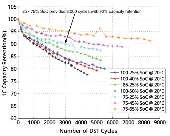

There was a question on FB recently about the definition of a charge/discharge cycle. As most of us know it's defined as a charge and discharge cycle of an energy quantity equal to the rated capacity. Wiki defines it as "... the process of complete charging and discharging". Added to that, a comment from Apple Inc. says: "... a charge cycle means using all the battery's capacity, but not necessarily by discharging it from 100% to 0%...".
So, completing a "cycle" doesn't have to happen from zero to 100% and 100% to zero in one shot. An accumulation of multiple charging and discharging events equalling the rated capacity is still a cycle, as there is nothing implicit as to over what range of SoC those events occur.
When we look at an Li-ion 16850 cell life graph (see below), the lines represent cycles between a number of fixed SoC values aside from the default of zero and 100%, eg. 25 to 75%. Those are plotted against "DST cycles", where they mean 100% cycles. So, the X-values on the 25 to 75 line are the cycle numbers normalised to a defined 100% cycle, i.e. half of that. If the cell life data for 25 to 75 indicates 3,000 "cycles" are available from a particular cell sample at a particular deterioration level (say 90%) then that actually means 6,000 cycles can be acquired when only going using it between 25 and 75%.
We already generally understand as owners that avoiding SoC extremes "can" increase the useful life of the traction battery. "Can" is just being scientifically-conservative or non-committal, I would suggest that the data shows that it most certainly will.
Obviously when you are driving the Kona it's continually discharging and (in much smaller amounts) charging (regen or 'recuperation'). That activity is depreciating the battery life and that is one of the reasons why the BMS records the four data values with titles that start with "Cumulative ...".
This annotated graphic for a single 16850 cell was created from the original copied from batteryuniversity.com
