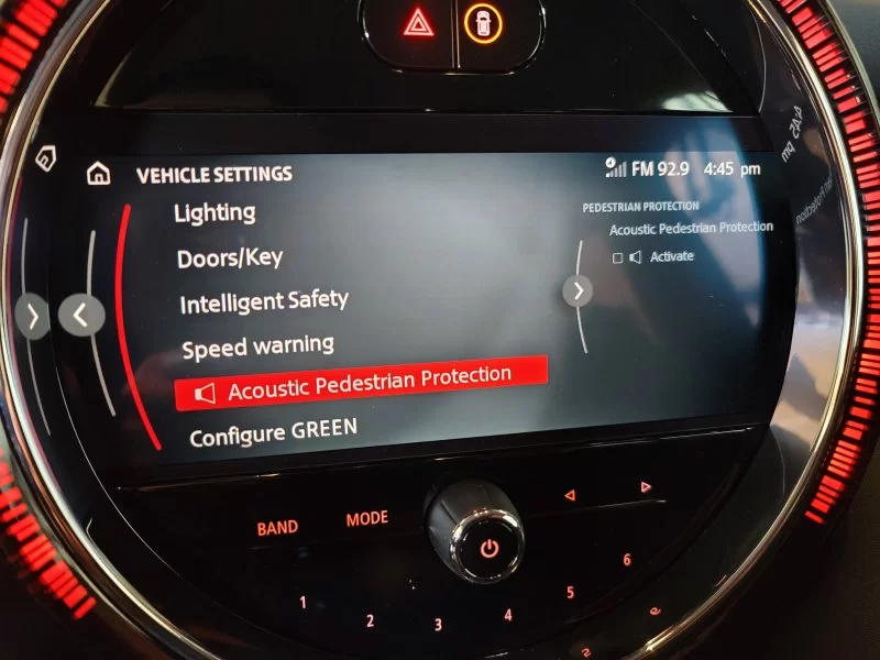

On my car this toggle deactivates the sound in both forward and reverse, for the duration of the drive only. Then it defaults to back on.
I remember mine doing that too but only the first time I select deactivate. The "remember" setting only seems to remembers the choice to disable it when going forward so after one shutdown the reverse noise comes back but forward does not.
The car threw a bunch of warnings while it was coding the seatbelt changes, but they went away after restarting the car a couple times.
Same here (I probably should have mentioned that). Any setting that reboots a safety system ECU makes the car panic and set a bunch of codes. Once you restart the car it realizes everything is fine and the errors go away.

Do you have to turn it off every time you drive? I enabled to option but I have to select it every time
There's a "hidden" option to remember it. Basically when you first connect BimmerCode, tell it your car is an i3. According to the BimmerCode documentation it should be called "Remember acoustic pedestrian protection" under the VSG01 control unit.
As I noted above somewhere, this only remembers the setting for drive. The noise in reverse returns after the car is restarted.
