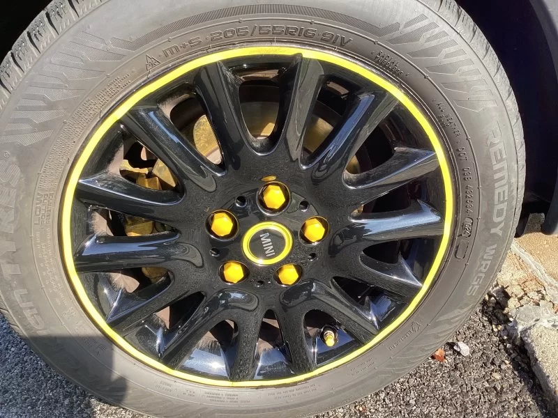

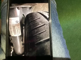

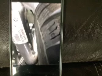

View attachment 24294 View attachment 24293 View attachment 24292. WRG-5 Nokian are all weather tires have snow flake on them not all season bc I can’t get them in 195 I bought 205 but I was worry they can rubs a shocks I put them with 10 mm Spacers but you need longer bolts for installation .In New York I run them from November to April I like them very much without noticing range reduction but I bet they will do better from April to November bc much hotter weather as they designed for all year around .I have extra 16” rims I don’t have to sweep them driving Hankooks through summer .Im seeing them as cheap $127.17 in size 205/55/16 on a Net

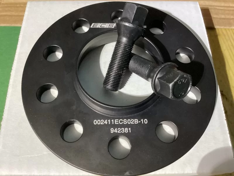

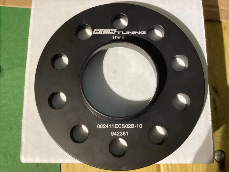

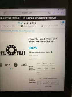

Which bolts did you use with the 10mm spacers? I am surprised ECS doesn't specify (or include) the longer bolts.
Thanks Rexsio. It's good to know that I might have some flexibility on the tire width if I can't find a good 195/55R16 all season.

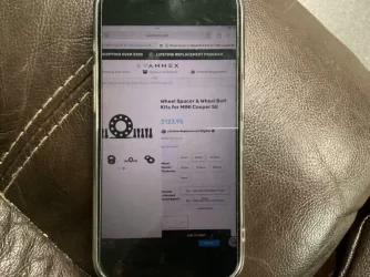

This is a web page I bought a spacers and bolts evannex.com

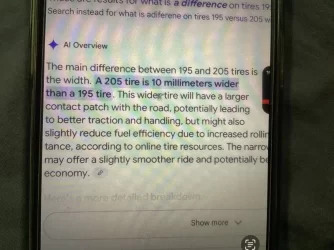

@Rexsio I'm thinking more about the Nokians as all-year tires on my 16-inch rims. In the end do you think the spacers were needed for the 205/55 R16 Nokians? Do you think the larger tires would actually fit well without the 10mm spacers? Thanks!
Some members were saying they fit 205 on 16” rim but as I mounted them on my second set of 16 “ rims and install them in my garage have time to look at them as 195 /16” rim OEM setting is like 1/4” from struts front I decided go with spacers for just safety reason . Those Nokians all weather come only in 205/16” rims unfortunately.When I ask tires shops they don’t want to install them on my SE .I drive for 1/2 a year I like them and I don’t realy see differences with my setting with spacers which requires longer bolts as I mentioned in previous posts Pic with Hankook and Nokian 205

As Nokians are not available for all weather tires WRG -Remedy for 16”rims only for Winter 16 “ full winter tires as I put on forum I get then 205/55/16 “ with spacers 10 mm as I was worry to rub a shocks as driving last winter in NY they perform excellent with spacers on SE with a bigger width of 205 as factory is 195/55/16” as 10 mm spacer is really nothing .
