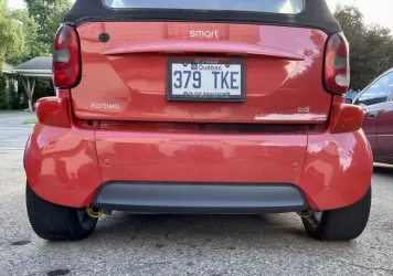

That just means MINI expects you to corner quickly! Typically negative camber and hard cornering results in even tire wear
Lol tell that to the 40-profile S.drives riding a 20 mm rear drop on my ancient smart!
Needless to say, it doesn't go out in traffic.

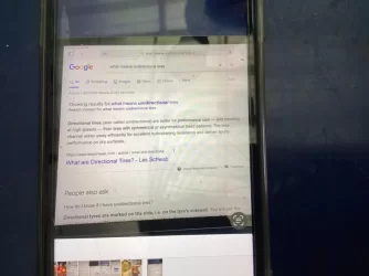

Flip them over.
you can rotate all of them every 5000 miles only on one side front to rear not cross as old time years before you start driving you get your driving license
I honestly can’t decipher that last part.
Symmetrical tires cross rotate like always (not “old time”).
Asymmetric [sic] tires also cross rotate like symmetrical tires, as long as they’re not “directional” or “unidirectional.”
Directional (or unidirectional) tires rotate front to back, whether symmetrical or asymmetrical.
