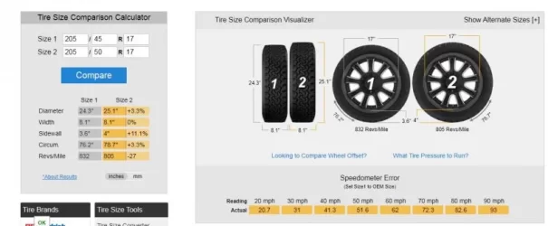

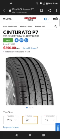

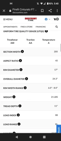

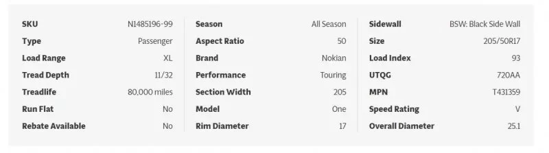

I'm gonna see if I can get these to fit. I hope with these I won't see any mi/kwh loss, I'm lucky to see 3.3 to 3.5 avg.
Some people (@Carsten Haase) on this forum know how to look up the European efficiency ratings, but I don't. Regardless of their efficiency rating, however, these tires will negatively affect your range because they're going to be heavier. Also, the greater diameter will alter the readings of your speedometer and odometer.
If I'm not mistaken, 720 is better the 260. What I have now are great for summer but now in any kind of snow.

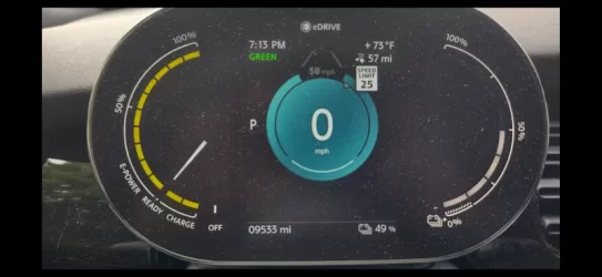

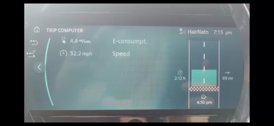

Got the new shoes on and went for a drive. 69 miles with 49% left. Have to say, very happy with them. Zero noise, but not sure why the range is so good.
