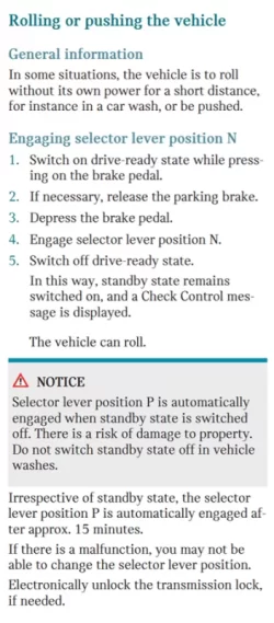

Can the SE be accidently or intentionally left in Neutral when it is powered down?
Not exactly. I just tried this in my garage and experienced the following:
  • There was a warning message that the transmission was not in Park and may roll.
  • With the car in neutral, foot on the brake, and hitting the On/Off toggle made the "power down" sound play, but the HUD and headlights remained on and I got a warning that the car's ignition was still on when I opened the door.
  • Hitting the Start/Stop toggle while my foot was on the brake from this state played the "power up" sound and it was ready to drive.
  • However, if I hit the Start/Stop toggle with my foot OFF the brake from this state put the transmission in park and shut the car down.
With the parking brake off and the selector in Neutral, will a single front wheel spin freely when that corner is jacked up?
I believe it would, but wouldn't recommend jacking the car up in this state given the risk of rolling. Setting the parking brake should be a minimum safety precaution.
Agreed, if a rear tire were punctured, put the SE in park so the car does not roll while you find the problem, power down and repair a rear tire without taking the wheel off the car.
If a front tire were punctured, set the rear-only parking brake to keep the car from rolling, leave it powered up and in neutral to inspect the tire. Find the spot, power down and repair it.
(Of course, chock the diagonal opposing wheel with whatever you can find laying around.)
From pages 103-104 in the 2020 Owners Manual:
@insightman You are the man! Thank you for the 15 minute tip. I think I should be able to find a nail/screw in 15 minutes, but it is good to know that once I find it and my hands are too dirty to reach into the cabin, all I have to do is wait a bit and the pawl will engage automatically.

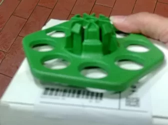

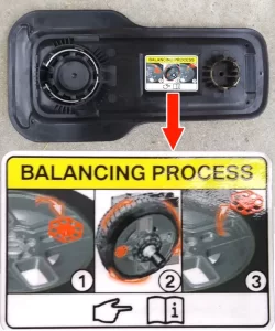

Here's a cautionary example of what happens when you try to balance power spoke wheels without the balancing widget:
https://www.facebook.com/groups/electricMINI/permalink/2864808520434430/ (apologies for Facebook link)
MINI includes the little metal tool for removing the power spoke caps, it's crazy they didn't also include the inexpensive plastic counterweight needed for balancing.
The balancer might be inexpensive to manufacture, but ECS sells it for $24.90. Wait! I just found it on sale for $16! I'm ordering one.
Someone who wants to be part of Facebook should tell this guy who still calls the wheels "Corona" he can see the special tool on the backside of the wheel cover (or "hood" as he called it).

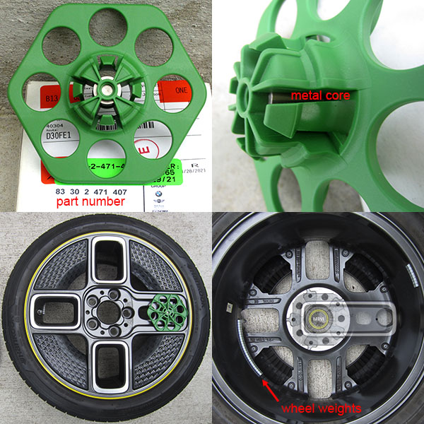

Today, I received my Power Spoke wheel "adapter" that simulates the off-center weight of the MINI Cooper SE Power Spoke wheels' wheel cover when the wheel cover is not in place on a wheel-balancing machine. There is a metal cylinder in at the core of the adapter that brings the weight of the adapter up to 175 grams. The back of my factory-balanced wheel (with the ghost-image of the wheel cover) shows that many wheel weights were installed to compensate for the asymmetric wheel cover.
I wonder how many meetings it took to get the green light to build such a small number of these asymmetric wheels that would also require the creation of this unique adapter? As @Puppethead noted in this post, one Brit who had his wheels balanced without having this adapter could no longer drive his SE with the wheel covers in place.
With MINI pulling back from making the SE look different from ICE MINIs, I'm surprised the Power Spoke rims continue to be an option on the high-end trims (Iconic and Electric Collection).
The liberal use of wheel weights is crazy, are you saying even the Oxford plant couldn't find one of the adapters for balancing? Now I'll have to crawl under my SE to see what's up.
No, if the factory had balanced the wheel w/o the adapter, there would have been fewer wheel weights on the opposite side from the asymmetric part of the wheel cover (and, like the unfortunate British SE owner, the wheel cover would cause unpleasant vibrations).
