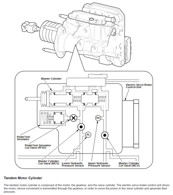

I did look at the brake linkage this morning and there appears to be a physical rod that goes through the firewall from the brake pedal into the back of the master cylinder. I have no idea if that's connected to the piston in the cylinder and can produce fluid pressure by itself, or if it requires the electronics/motors to build pressure. Hopefully some of both, with normal braking function requiring the electronics/motor but with a fail-safe of a mechanical connection as a last resort. The diagram posted by @insightman from @AnthonyW doesn't seem to explicitly show the mechanical connection. Further, the parking brake is operated by a switch and a motor, not a mechanical linkage operated by the driver. So in an electrical failure of any type (fuse, switch,motor, wire, etc), or a mechanical failure of the mechanism, you are SOL with the parking brake. I'm going to cc this post over to the Brake Issue thread too.

I'm certain that like all current automobiles, the Clarity's braking system has redundancy. However, I've never heard of a brake pedal going to the floor in a modern automobile, which makes me wonder what happened. Here's the diagram from the PDF document. It seems to me that the rod attached to the master cylinder must be connected to the brake pedal. If there was an intermediate device between the brake pedal and the master cylinder, I believe it would be part of this diagram. I don't see any redundancy in this diagram and I don't know what the "motor" and "gearbox" are in the braking system.
