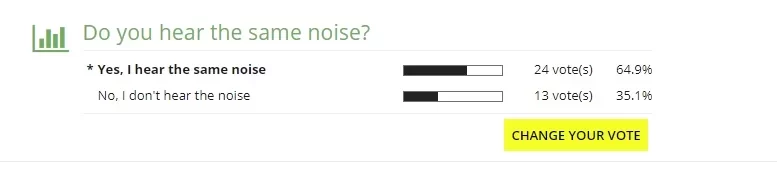

Do you hear the same noise?
  • Yes, I hear the same noise
    Votes: 60 69.8%
  • No, I don't hear the noise
    Votes: 26 30.2%
  • Total voters
    86

In order to allow us to track any historic trends in the poll, I will occasionally attach the results at time of posting. This way we can reference the older posts in the future to see if current poll results are improving, staying the same, or getting worse. So far I have not seen the kind of improvement I would expect to see if KIA actually solved the problem on recently manufactured cars.
Anyone can change their vote, so please don't forget to update if your car develops the problem in the future. The more people vote (yes or no), the more statistically meaningful this poll will be. Thanks.
