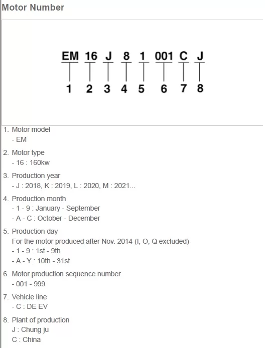

FYI: I forgot to include a picture I took of the motor model, this 2020 was delivered on May 18th 2020 and has the 710 motor.
Decided to reply in this thread to stay on topic. Thanks for checking the motor revision. That matches what I personally saw on a 2020 a few weeks back and what all 2020 owners I questioned found on their cars. In case anyone is wondering, these are not old inventory motors. They were manufactured very recently as can be seen from the date code on the motors. I assume the 2020 motor you saw was also recently built? (I posted decoder diagram previously and attached again below).
I forgot to post my 2020 sighting in this thread so here is a repost from a couple weeks ago:
Just a quick FYI. This week I saw a 2020 model year Niro EV for the first time here in the USA. Car was just delivered to my dealer and I only observed it from the outside. Didn't want to risk test drive with the current virus situation. I took some pictures of the motor and can confirm what other owners reported above - MY20 Niros still come with the original E710 motor. The manufacture date code on this motor was from 3rd week of March, 2020. Car VIN was 36xxx range. As a reminder, my replacement E711 motor was manufactured in first week of November, 2019.
These repairs come up enough (and cost them enough money) to take notice, and Kia still uses the same part number. This means Kia does not believe the motor design is the problem. It might a motor production problem or it might be an assembly problem or design problem in some other part that is the root of this issue.

With such low mileage, was your 2019 Niro recently produced or just sat around not being used for a long time? You can find out the date motor was produced from a diagram I linked a few posts back. There is also a date code for entire car on label inside door frame (driver's side in USA).
