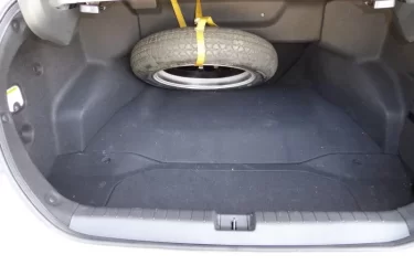

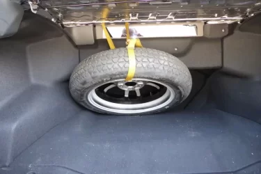

The Infiniti spare is the one I use. Here is a picture of how I mounted it.

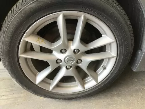

I have a full sized Nissan Maxima 18x8 wheel (v pattern) that looks like this:
I think this Nissan Maxima wheel design has the same +50 offset as well...
These will either use acorn (conical) or mag-type lugs. The one I have uses mag-type. Both will need the 64.1 mm to 66.1 mm hub centric ring adapter.
I also have the 17" Infiniti spoked aluminum temporary spare. It uses acorn (radial) lugs (but some of these also use mag-type so you have to see the wheel to know) and also needs the 64.1 to 66.1 hub centric ring adapter.

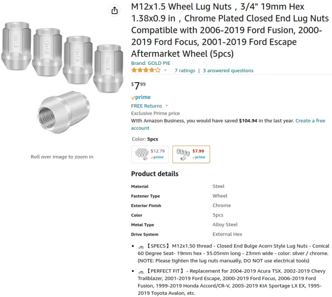

These are what I purchased last year:
https://www.amazon.com/gp/product/B097SYX963
Amazon products sometimes come and go, so here is a screenshot of the details:
* Make sure you have a compatible wrench - I bought a 'kit' with the spare that included a jack and a lug wrench.
The Infinity lug wrench did not fit, and I had to get a different one.
Also, you need the 64.1 to 66.1 hub-centric ring adapter.
You may have trouble finding a replacement tire. I don't think it is too common to replace them, but as you know, the tire you bought is about 4% too large. The 145/80/R17 is not perfect, but it is only off by 0.7%.

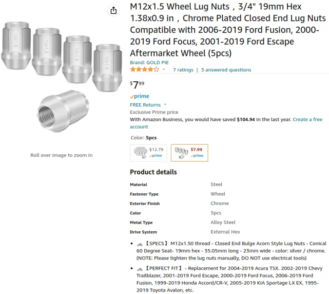

Did you secure your spare somehow to keep it from moving around in an accident? Where and how did you store the jack?
