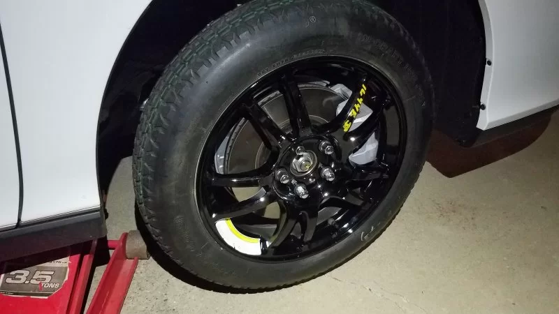

I bought a flat repair kit, one of those tire plug kits but I still felt uncomfortable on long trips with no spare tire. So I started to research to see what donut spare tires may fit.
The various Accord models have donut spares but the problem is that they are only 15 or 16 inch wheels and the Clarity appears to have extraordinary large brake calipers and discs. By my eyeball test, it looked like it would be a really tight fit even with a 16 inch spare. The last thing I needed is a donut spare that doesn't fit, so I looked elsewhere
I discovered that many Infinities and Nissans also share the same bolt pattern as the Clarity. More importantly, for some of the Nissan 370Z and Infiniti G37 models, they come with 17 inch donut spares. One bonus is that some of them have alloy donut rims rather than the usual steel donut rims. This will save a little weight.
Another benefit is that these donuts are fairly large. They are basically the same size as our standard tires. Normally, I would be fine with a small donut, to save on space, but given the electric motors on the Clarity, I wasn't sure if sustained differences in rotational speed will be bad for the car.
So here is a G37 donut spare installed. I bought it on eBay for $97, plus an additional 15% off coupon that ebay periodically sends out. The seller, mullinsautoparts, was fantastic and shipped the spare immediately. It was also in new condition.
The spare tire was listed as:
2007 2008 2009 07 08 09 Infiniti G35 EX35 Sedan 17x4" Compact Spare WheelView attachment 1518 View attachment 1518

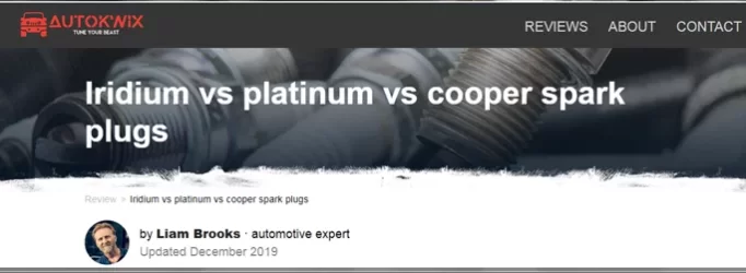

My first impression of Autokwix was LOL based on the large headline for this "Updated" article by an "automotive expert":

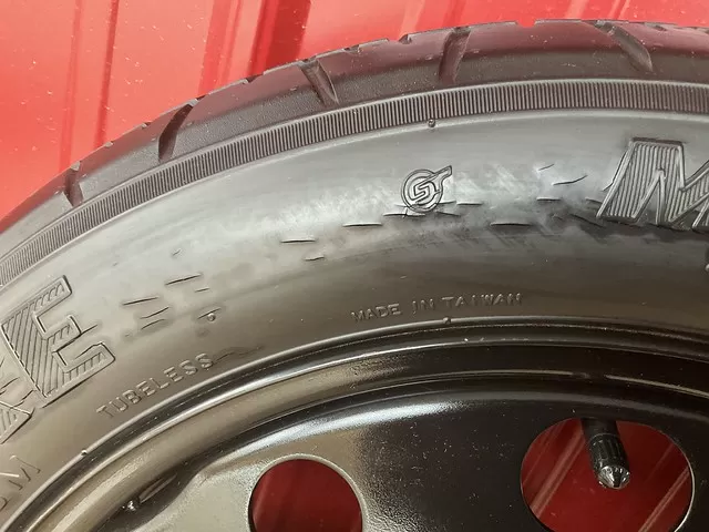

Ordered a compact spare and jack from an ebay seller. Arrived yesterday, and I’m pretty disappointed. These sidewall cracks would make me very nervous if I ever had to use it.
I contacted the seller about a remedy and haven’t heard back yet.
Like I said, disappointing.
