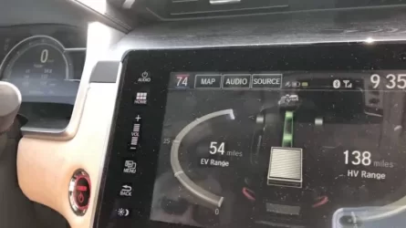

So what is your conclusion about how the Clarity is using up the excess energy? Do you think Honda believes it would be too confusing to show the green bar going from the battery to the engine?
It's interesting to learn that after depleting the battery, the engine immediately restores the SOC to full. What is the cycle-time for this discharge/recharge? Does it take place over and over without the engine shutting off when going down a long mountain descent? Or does the discharging continue on the descent and when the need for discharging is ended the engine continues to run until it restores the SOC to full?

I have posted that in fact, the ICE does charge the battery. There is a clear flow from the ICE to the battery.
I was talking about the other way: a flow from the battery to the ICE could be used to indicate the running engine was being used to burn off energy the fully charged battery cannot accept.

So this morning I got to make another observation. Initial reduction in state of charge and then assist. Came to the first red light and ICE is giving charge back to the battery. It turns off when the coolant temp reaches 159F. As I continue to drive ICE stays off until the coolant temp falls to around 130ish (I missed the precise temp). Ice comes back on. Stays on until it reaches the mid 170's (I missed the precise temp). Ones it hit that temp, the ICE went off, stayed off and the blue line came back.
So I am guessing that it gets to it's operating temp in 2 stages. After the red light, I get right on the highway and so I reached the 170's mark fairly quickly. I can see how the ICE may cycle on and off multiple times for people who are driving surface streets and not going very fast. That would explain why it might come on 4 or 5 times before it turns off completely. Once you hit 159, it turns off but will continue to cycle back on until you hit the mid 170's.
So anyone with an OBD scanner can try this and confirm if the same thing happens to them. All you need is the RPM's and engine coolant temp which I was able to get from my old OBD.

AnthonyW, the deeper you go, the more mysterious it seems. Do you think it's always the case that the ICE won't be happy to get to just 159 degrees and will always re-start to get to the mid-170's?
Is the temperature the only available OBD signal that indicates the engine is running?
I think that the engine will always run until you hit 159. If you stop (stop sign, red light) after you have reached 159 but before you have reached 175 (lets just call it 175 for now), the engine will turn off like a regular hybrid. Once you get going again, it will cycle back on and continue it's climb to 175. If you stop again before 175 is reach then it will repeat the same process. That is my thought about what is happening and may explain why some people have the ICE stop and start 5 times before it stays off.
I had MXV (SOC), voltage, RPM's and engine coolant temp showing on the Scangauge. When the engine was running while I was stopped, it was right at 1500 RPMs. While driving about 60mph it was around 2300RPM's. There is only about a second delay after the ICE turns off and the RPM goes to 0. I just missed the exact temp readings because I didn't know where the target was and I was driving. Now I know when to look so I should be able to get the exact temps next time.
I forgot that the Scangauge records the highest readings of certain PID's for each trip. The engine water temp hit 177F before the ICE permanently shut off.
