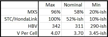

MXS - Behind the scenes State of Charge measurement of the battery which I believe is the true SOC.
HBV - voltage of entire battery pack.
STC - Regular SOC that you see on your Hondalink app. Just has a decimal here.
DCT - Temp of the DC to DC converter.
See this grid to see to see how they correlate:
*Since our battery is a 84s2p, I divided HBV by 84 to get the voltage per cell.

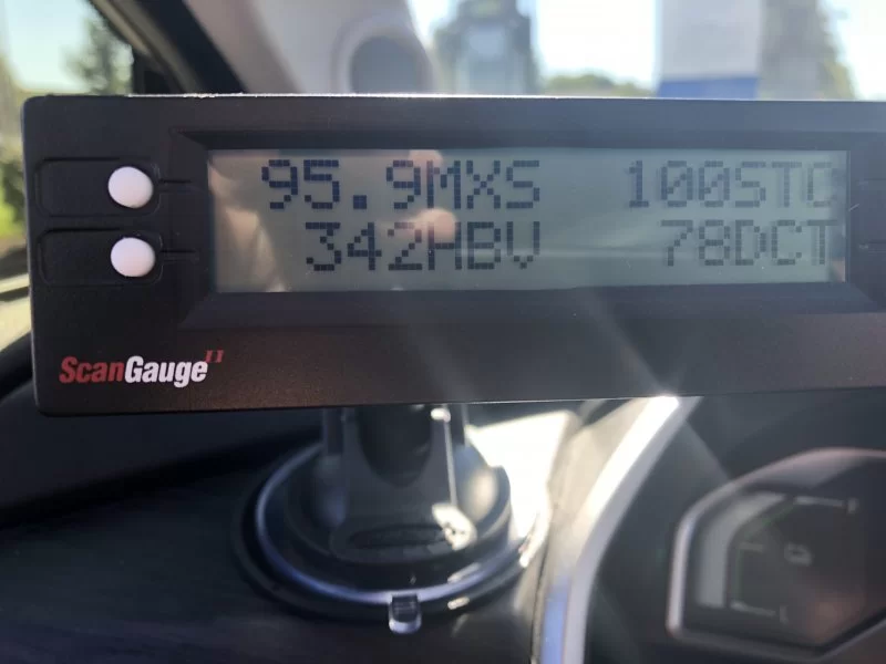

I have a free ChargePoint charger within walking distance of my work. When I picked it up the MXS was 95.9 and HBV was 342. I only charge to full twice a week. Other days I try to keep the MXS between 90% to 40% (92% to 35% on HondaLink). When I charge to full, MXS is always 96% but last week it was 95.8% and, today it was 95.9%. These are true OCV measurements because once the charge was all done the car sat for about 2 hours before I picked it up (that is what is pictured). It is about 0.3 miles to drive it back to work. No hills or declines, just a parking lot, an intersection and my work parking lot. Backed into a parking space, put it in park but left the car on to listen to Sirius while I put up my front window shade. All of a sudden the ICE kicked on. Scared me half to death. Because of the way I charge, I have not had an unexpected ICE turn on since the first month I purchased the car (April). I look at the Energy Flow on the display and see the green power bar flowing from the engine to the battery. I think to myself, Honda should fix this, the green bar should be going to the ICE not from.

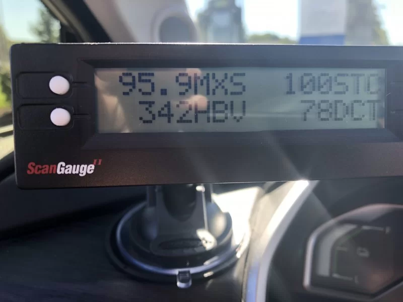

Then I look at my Scangauge and that is what blows my mind. Driving the 0.3 miles had reduced the MXS to 95.5%, STC/HL to 99.2% and HBV stayed at 342. But when the ICE kicked on the values started to increase. It ran for about a minute until the readings of 96%/100%/343 as shown in the pic below. Once MXS hit 96% the engine shut off. The HBC went up to 343 which I had never seen before. I looked and say the "Ready" indicator was still on so the car was still on.
