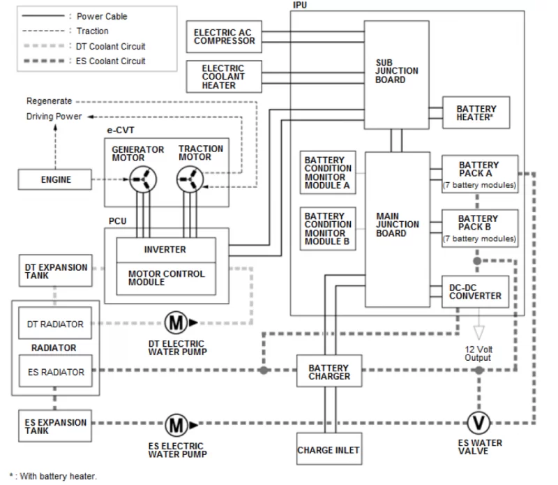

The paper from 2003 describes the development of an oil deterioration factor that appears to be highly related to temperature. However, I don't believe their validation methods in that timeframe would have included the Atkinson engine which runs cooler than traditional engines. So, without seeing more recent science experiments, I'd say they need to do further research to validate the methods described with engines that run cooler.
Additionally, they appear to be monitoring the water coolant temperature (and a few other variables) to estimate the engine oil temperature. Within the 'Electric Powertrain System Description 3107' pdf, I must assume that the 'DT (drivetrain) Coolant System' is the one whose temperature would be monitored for the maintenance minder logic unless there is a third coolant system not shown for the engine. If there isn't a third system, then the temperature monitored for oil deterioration is being inflated by heating in the PCU and unrelated to engine engagement.
The question remains: Has Honda failed to update the Maintenance Minder logic for the Clarity and was this an oversight, a budget decision, or intentionally to maintain a revenue stream for service departments?
There are 3 coolant systems, including one for the engine.
This is what the press kit says when the car was released.
"The Maintenance Minder™ system monitors operating conditions such as oil and coolant temperature along with engine speed to determine the proper service intervals. Depending on operating conditions, oil change intervals can be extended to a maximum of 12,000 miles, potentially sparing the owner considerable expense and inconvenience over the life of the vehicle. "
