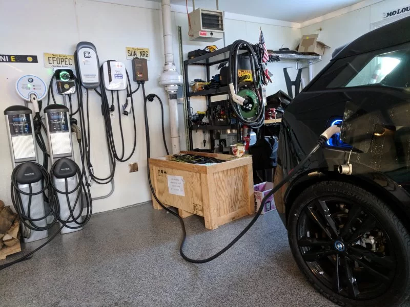

I've been testing and comparing EVSEs for about six years now and have written many reviews (some posted here on InsideEVs) and I can definitely say that there isn't a one-size-fits all solution. People need to think about what features, if any that they would like to have before shopping price.
FWIW, I love to have the WIFi capabilities and smart charging features and I'm willinig to pay a couple hundred dollars more for those features. I just posted a review of the JuiceBox Pro 40 (I have three of them) and it's definitely very high on my recommend list. Heres the review if anyone is interested:
http://bmwi3.blogspot.com/2018/04/ev-charging-product-review-update.html
