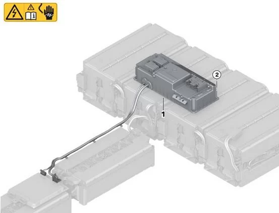

Well there is a grounding and fuse box that sits under the rear seats (61279455518). That wouldn't directly detect a thermal event, but it could prevent a widespread runaway. Apparently one German SE driver had some issues and the HV fuse blew twice presumably DC fast charging after heavy rain 2 days prior. A US SE driver also experienced some HV issues while doing 75mph on the highway.

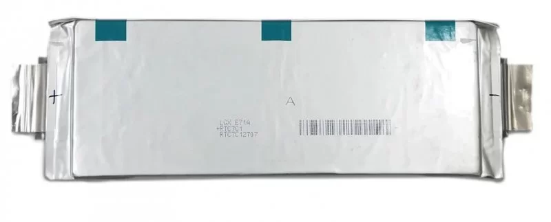

For the Bolt, I recall the issue being the misaligned and folded/torn separator on the anode tab side. That shouldn't be an issue with the more rigid prismatic or cylindrical cells. Fortunately battery manufacturers serialize the cells to a batch production date in case of quality control concerns. If the CATL cells in the SE changed throughout the production years, BMW would probably have identified the issue immediately. Since it's potentially a global recall for every vehicle, then it doesn't seem like the problem is coming from the CATL prismatic cells. What I mean to say is that the SE has 96 HV cells in series and the cell voltages are added to get to the 350V-398.4V range (~4.15V x 8 for single pack [x2] and ~4.15 x 8 x 2 for the double pack [x5]).

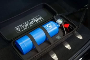

That's why BMW now includes a fire extinguisher for Korean models.
