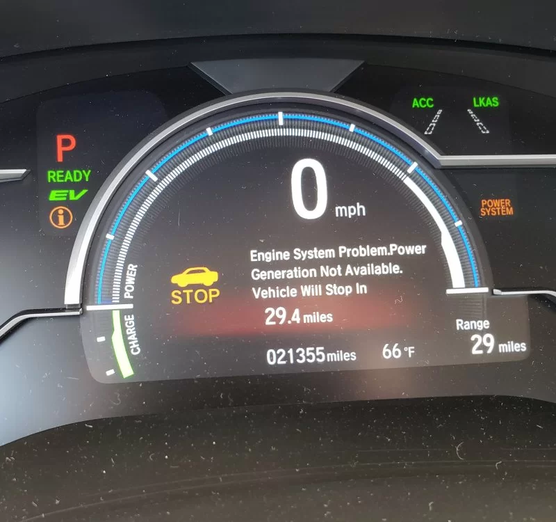

I'm assuming your car switched over to EV automatically when you ran out of gas? Did you have any problem restarting the gas engine after fill up as stated by others?
The car switches to EV and displays a warning, and sticks until you fill up (telling you to stop and fill with gas). My wife didn't test if the car will restart in this state (if you don't get gas).
As I said, it was totally seamless. No problems after filling with gas. And I never saw the message posted by Viking79

When running in hv mode the gas engine will die if running and fail to restart in subsequent restart attempts. 0 indicated range is there just to scare you into getting fuel right now. When you filled at 6.9 you likely had another .2 gallons left before you were actually out of fuel. You likely had another 8 or so miles left before it was clear out. We are definitely in now you know mode. If you are in hv mode and are running single digits it will keep going after it runs out but it gets VERY angry. If you have EV range left you might want to go from HV mode back to Econ when indicated hv range hits zero as you gingerly get directly to a gas station.
I wonder if the message came with a software update (like for HV range)? Or as you say maybe not totally empty. My wife's took 7.17 gallons to fill.
After filling with gas the engine started normally the next time it ran.

I forgot to note that I never received the warning image that Viking posted above on my display. I got a low fuel warning but certainly never saw a Vehicle Stop warning as depicted in that image.
I wonder if they have changed something to prevent you from actually running it dry now?
Not sure I understand your question .... To my knowledge I did run the gas tank dry in my experience this weekend as there was zero gas range left and the car switched itself from HV to EV mode. I then was able to add 25.0 litres which is I believe is the stated tank capacity. The most I've ever been able to add previously has been 23.03 litres.

Prior to the Software Updates the car in hv Mode ran down to the point the Engine stopped running, the ecm repeatedly tried to restart the gas engine prior to throwing up the warnings I described. It definitely differs from the experience GV Ottawa and Peter Krone Berg described. As I said ymmv but I’m not testing it again ;)
