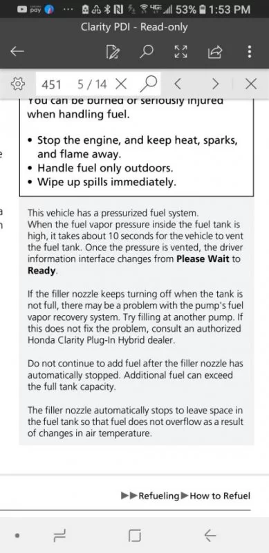

"I'm not sure about the Clarity, has anyone tried to see how much more gas they are able to add after the pump clicks off?"
@Electra, the manual specifically says not to overfill. Page 451 of the manual. Could affect the pressurization.
