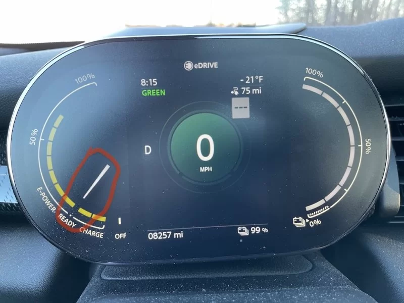

There's no way to turn regenerative braking off? I often find myself coasting when in traffic
There are two ways to disable regenerative braking in the SE:
  1. Shift into neutral.
  2. Hold the e-power needle (left gauge) in the narrow "ready" gap between accelerating and regenerating.
