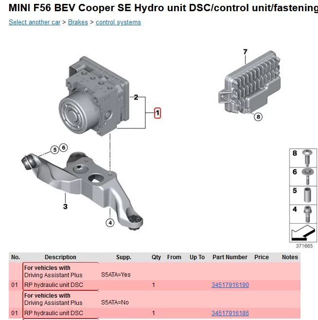

So this Active Slip Regulation works for acceleration, would it also be used for regenerative braking to blend in the friction brakes?
The friction brakes would be some other controller (probably the ABS module?)
The fancy active slip regulation is just the electric motor, the friction brakes anti-slip is still old school with very noticable pulsing
The RP hydraulic unit DSC 34517916190 sure looks like an ABS module.
