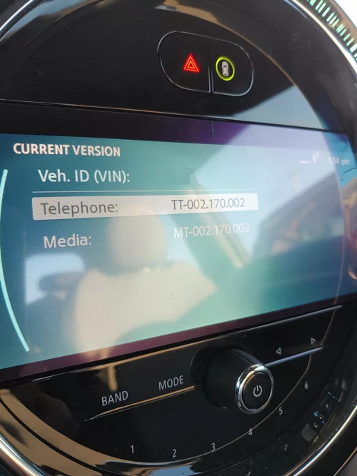

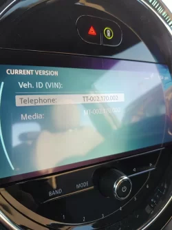

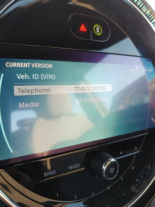

Let us know if the screen saver is gone. And if I may burden you, can you share a pic of the current version screen?
No clock screensaver, but I should poke around more of the menus. You can turn the screen entirely off.

My versions are 002.162 so not worth the trouble of removing the fog light switch and trying to remember all the coding I did…
