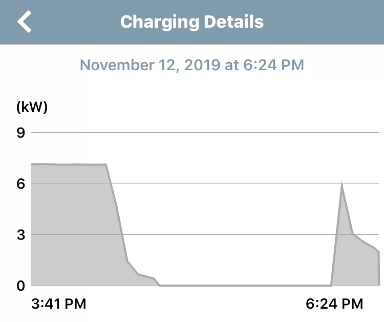

1. On my Charge Point Home Level 2 EVSE, preconditioning uses the battery even when plugged in if a scheduled charge has time ended beforehand. As long a charging event is ongoing or has finished adding charge and the app shows a flat line of 0 kWs, preconditioning draws from the EVSE and keeps the battery full.

3. 20-25 min or so preconditioning in a garage at 50 F gave me a toasty warm car and used 1.03 kWhs grid power as shown on the right of this graph.
Hope this helps explain why some are having trouble w HL preconditioning while some if us are not. It’s not well explained or documented my Honda, so there is a learning curve.

So about $.10 worth of burned coal to get the car warm. Now the thread can really drift.
Or did you install solar?
I’m one year into solar PV with enough capacity for all housing and transportation needs, even taking into account the small but unavoidable degradation of the panels over the years. There are a few of us who are environmentally conscious enough to put our money where our mouth is here in Kentucky coal country. Solar and electric cars pair very well both for the environment and the wallet if you take a long term view. (And yes, I am aware of sourcing, production, and life cycle environmental impacts which still are better than the same with gasmobiles and fossil fuel electric generation.)
