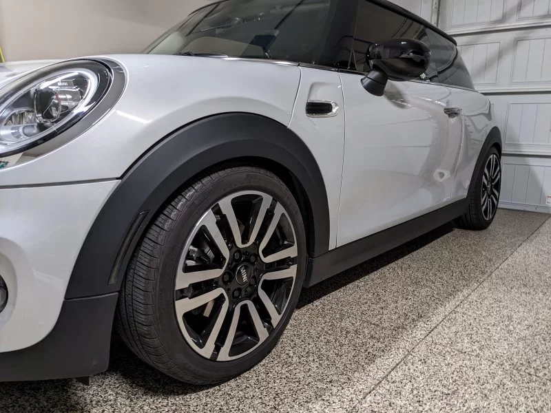

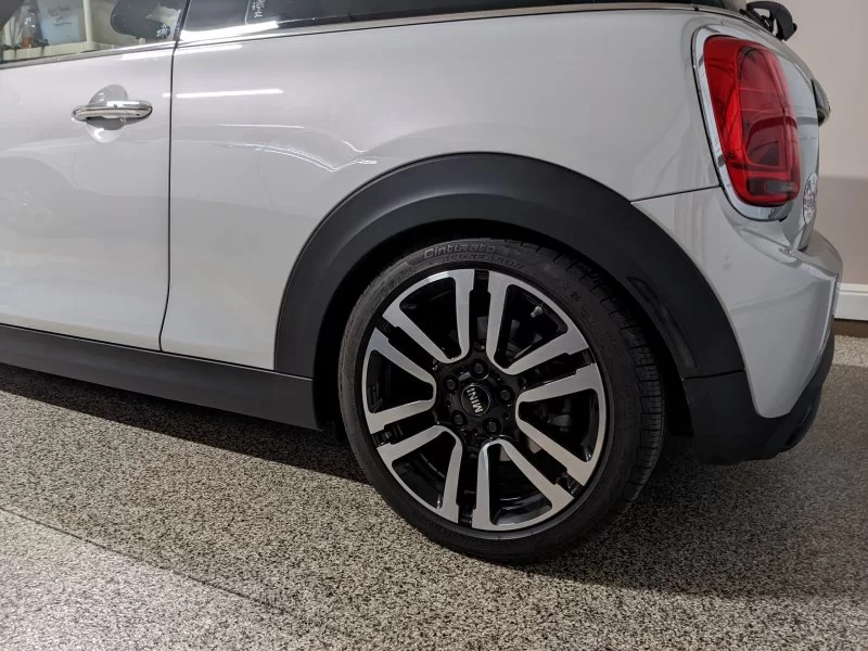

15mm front and back with my old tires.

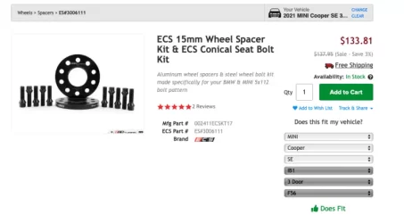

I can't comment on tire recommendations but another modification suggestion would be wheel spacers. They're not expensive and easy to install and give the mini a bit of a heftier stance. I use 15mm spacers in the front and 20mm in the back. ECS Tuning has some good options. Just be sure you get (the proper) slightly longer lug nuts.
Agree. @F14Scott provided links to a really good set of spacers as well as the longer bolts. One note, though: if you live somewhere that gets real winter and lots of salt is spread, it’s wiser to keep the spacers off until spring. Even though many of the spacers are anodized or powder coated, the spacers will live in a harsh environment and are subject to wear and the salt will cause serious galvanic corrosion in short order. That can lead to worse problems, including off-balance wheels and shorn bolts.

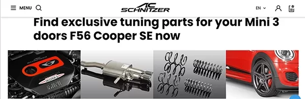

Seems like AC Schnitzer has SE specific springs. I know a lot of the times they will just re-brand eibach or H&R springs; but sometimes they adjust the spring rates. Maybe I can be the guinea pig.

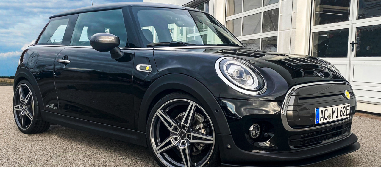

They also have a nice looking front lip that bolts right on.
I enhanced my SE's aerodynamics by deleting the fake hood scoop, but I couldn't find any aerodynamic bits for the SE on AC Schnitzer's website. Can you provide a link?
The pic doesn't match, but the press release shows it. I confirmed with AC Schnitzer in Miami that it does fit the LCI SE.
https://www.ac-schnitzer.de/mini/electric/3-tuerer-f56-cooper-se/
AC Schnitzer front splitter for MINI JCW (F56 LCI2)
