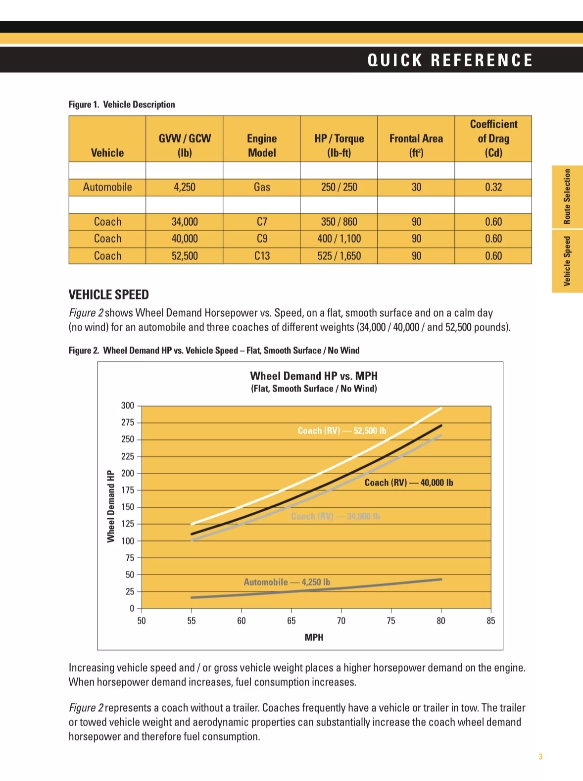

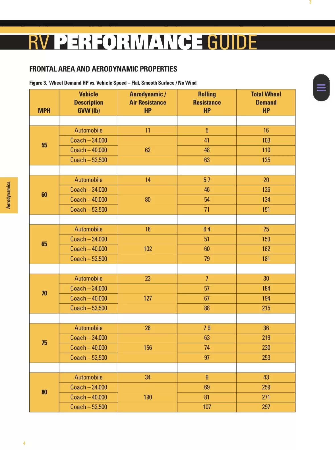

I'm very curious how you calculated these figures. You using a drag coefficient calculator?
They’re taken from a Caterpillar report on motorhome fuel economy. The document included data for a 4250lb automobile. Below are a couple of screenshots from the document.

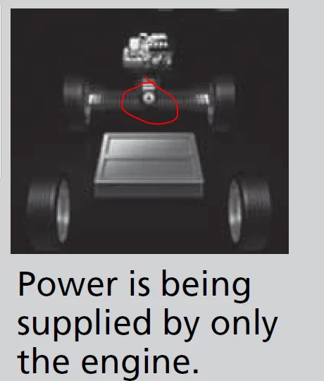

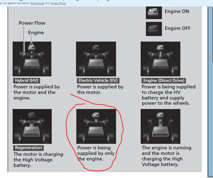

I have seen the car run purely from the engine and not drawing any battery whatsoever, according to the monitor in the car. It is rare, but I have definitely seen it. Also, little gears appear on the screen that you can see through the steering wheel when this happens.
Once again, this is rare but I have seen it run in engine only mode on occasions.
Page 132 in owners manual shows this:
Here is a zoomed in image showing the turning gears that only appear when the motor directly powers the car. It appears in 2 of the 6 images above- middle bottom row and far right on top row.
You are right. Good catch. I have seen that but only for very brief moments.
