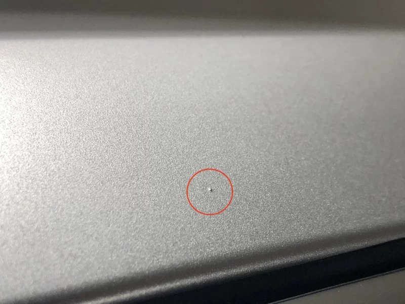

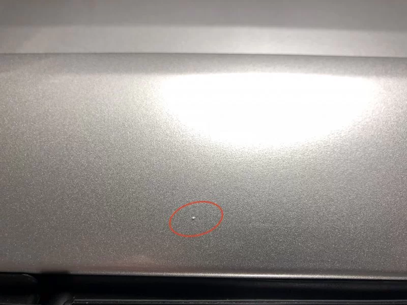

I just bought mine 2 days ago and there's a tiny dot on area above the rear door on the driver side. Should I be concerned at all that this will turn into paint issues eventually?

I would say that it is reasonable to expect to see some small imperfections in the paint. I would keep an eye on it though and if the spot grows larger or develops any cracks, take a picture of it and take it to the dealer immediately so that you have it in your service history that the paint is starting to crack.
I don't know if that would do you any good or not. My own situation is still playing out.
(If the spot starts to swell in size, get a picture of that as well, and take it to the dealer at that time.)

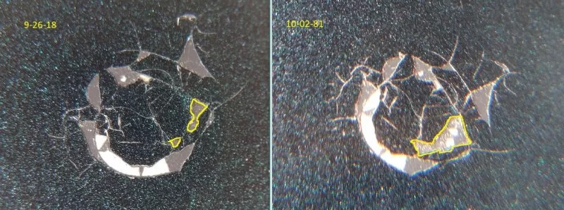

Latest pic. About 5 days apart. The yellow line shows what used to be two separate spots where the paint had come away from the primer, and the right picture shows how the paint between them has now come away from the primer to merge the two small spots into one larger spot. Also, I suspect that this particular spot is over a spot weld in the roof.
Does anyone know what the white is? It appears to be under the primer. As far as I know, the roof of the Clarity is steel, but perhaps it is treated with some chemical to etch it.
Here is a picture of a crack that appears to be growing in length. The root of the crack is visible in the left picture but that picture either did not catch the full length of the crack in the finish, or it has grown considerably. I can't say which of these is the case, but what I can say is that there are several cracks radiating out from this spot on the roof.

Thank you so much. So I think the white I see must be the E-coat, which is under the primer. Very useful.
Again, thanks.

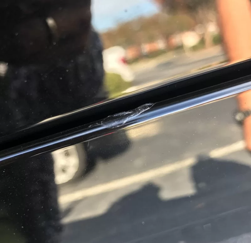

Hey everyone I’m new here but I’ve been lurking through the forums regularly. My husband just noticed that the clear coat (?) is peeling off the top of my gas door. He was asking if someone tried to pry it open. It looks like plastic wrap coming off the paint...anyone else have this issue or have an idea what this might be and what to do about it?
Is he sure it is not actually plastic wrap from the delivery wrapping? I still find little pieces of plastic wrap around my rear view mirrors and door sills.
...you’re probably right. Just panicked. Way for me to intro myself to the forums, right?! Smh.
