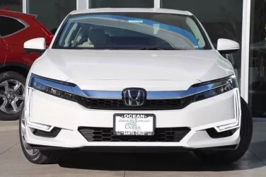

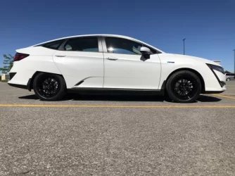

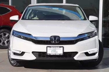

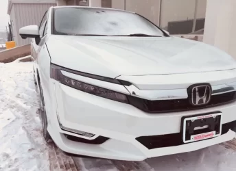

Here's a mod:
Playing around with the black plastic on the front end using MS Paint (apologies for the lack of photoshop skills or even software)
Kinda makes it look less spaceshipy.
What do you think?
I thought I’d grab a can of white plastidip and test it.

Wow! The Honda design team should give you a job. I have the white and that definitely looks much better. I’ll take the 4th picture.

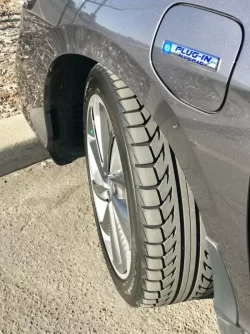

Switched from collision mitigation to collision prevention. BF Goodrich Comp 2 summer performance tires - braking performance (60mph to stop) 79.4’ vs 98.3’ for the stock Michelin’s. Gain 20% better stopping distance and lose about 5-8% on battery distance. I have already had one oh **** incident - got stopped with 15’ to spare from 45mph and I was thinking I was gonna hit. Sweet. And handling is so much improved.
I bet the sidewalks are much stiffer to help with initial turn in and feel.
Did you get the exact OEM tire size?
The sidewalks seem to look less curved and the tread wider. I’ve seen many aftermarket tires with the exact same tire Spec as OEM have an actual wider tread and much squarer sidewalls.
Yes I have the exact OEM tire size. They manage the heavier weight in the turns better. I love the improvement in road feel.

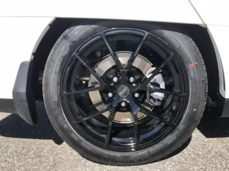

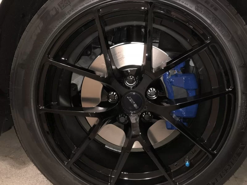

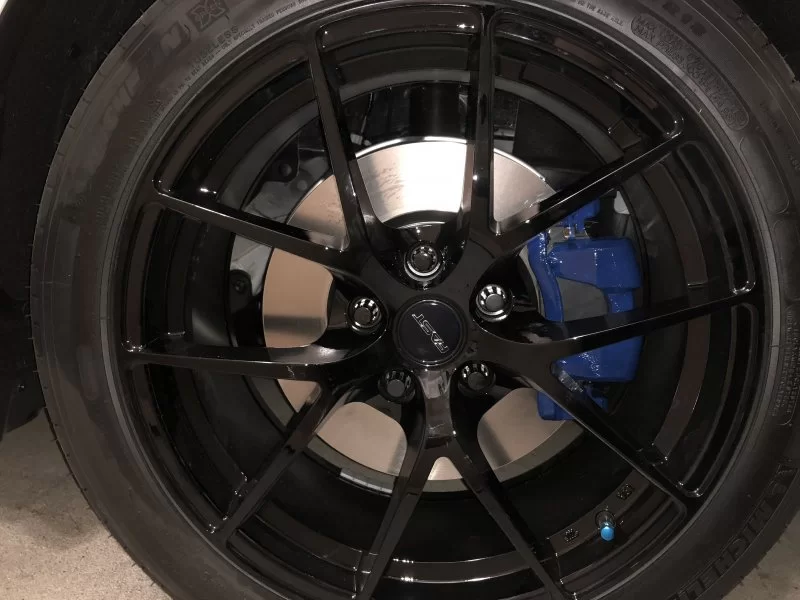

Today’s mod: painted brake calipers to protect from rust and add a touch of riceboy.
Was debating doing this until I saw a relatively new Accord with rusted calipers.

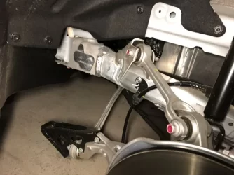

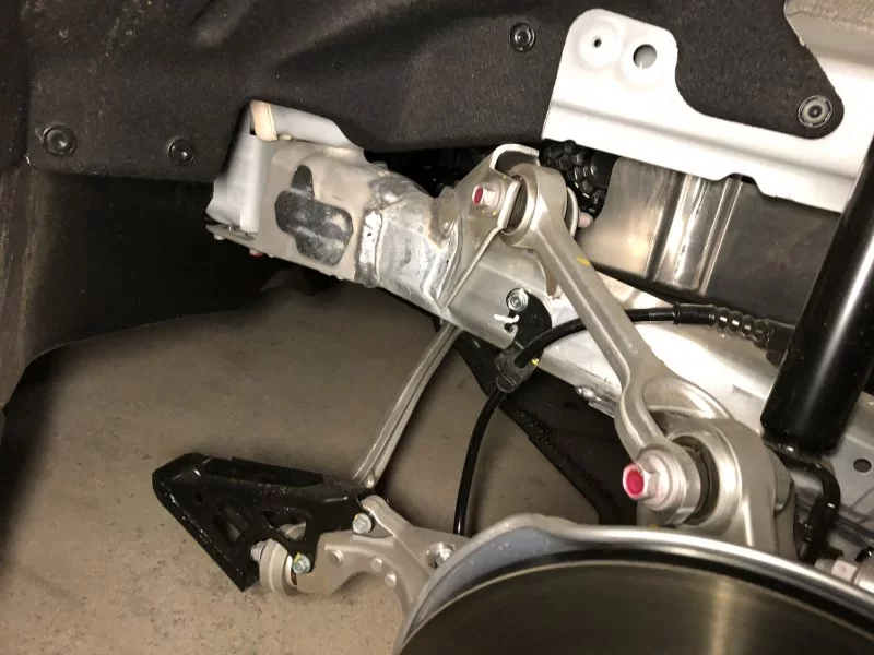

Also added a pic of the the rear suspension links and mount points. Look at all that aluminum.
