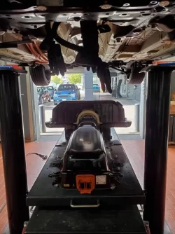

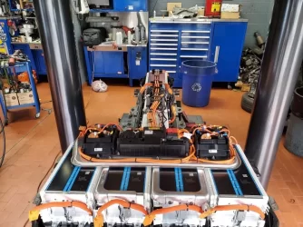

You're right, the entire tunnel is filled with batteries. Not sure if it is more or less stiff as it might just be a plastic cover with waterproof adhessive sprayed over. The two parts of the chassis may not be joined. I'm not sure, I don't have my car yet so I can't get underneath, but this is what I can see from Savagegeese's video:
It's a giant piece of stamped steel, it's supporting the weight of the battery and also needs to be strong enough to prevent road debris from puncturing the batteries
You can see the mounting points along the edges:

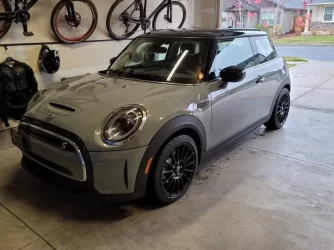

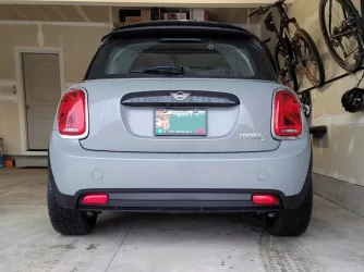

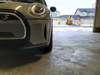

Not sure how the P7s compare to the 16" Hankooks mine came with but switching to 215/45R17 BFGoodrich Comp2 A/S tires completely transformed the handling. Steering felt much more precise and there was a heck of a lot less sidewall flex (which can feel a bit like body roll). Ride was definitely more harsh and range took a huge hit but it was worth it for me!
Alignment still needs a change to remove understeer but I haven't gotten around to that yet
@Carsten Haase do you have pictures of the tires on the car? Are you using OEM wheels?
I've debated getting 215 vs 205 but was leaning towards sticking to 205.
I'm using OZ Superturismo LM wheels (17x7.5 ET50) with 3mm spacers. They technically fit without the spacers but I wasn't totally comfortable with the tire/shock clearance.

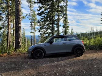

Yes, I have experience with Michelin Pilot Sport All Season 4 tires on my SE in these configurations:
  • 225/45ZR17 tires on NM Engineering RSe05 wheels (17x7.5 ET40)
  • 205/45ZR17 tires on OEM Roulette Spoke wheels (17x7 ET54) with 12.5mm spacers
The wider contact patch of the RSe05 setup noticeably increased cornering grip (at the cost of some reduced efficiency). Now that I have all-seasons on my stock wheels, my plan is to replace the tires on the RSe05s with efficient high-performance summer tires to see if I can get the best of all worlds (or at least more of them).
