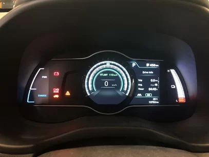

On the first trip, my wife noticed a significant range drop at around 45km from home (on the return). Range started to drop like a rock. She managed to get home with about 10% battery and the system telling her to charge immediately or something like that. No worries at this point, I wasn't there, but assured her that range estimates can vary and might change and are only estimates.
On the second trip (left the house at 100%), she stopped at the same DC fast charger at about 350km out. Charged to 80%. That is when things started to get weird. She called because she couldn't undo the charger from the car. It had completed to 80% but wouldn't release the plug. I walked her thru the unlock doors (which she reminded me she knew and had done several times before calling me). but the strange thing is that the car would not "unlock" with her fob (bad battery?). Lucky for her, the car was "unlocked" with the doors open and the windows down. I told her to try hitting the "auto unlock" button on the lower LHS while I fumbled with the bluelink app to unlock the car. After some combination of this, she was able to unplug the charger and return home. No issues on range this time.
So I plug the car into the Level 2 charger and think nothing of it.
In the morning, I find the manual where it tells you how to unplug manually by popping the hood open. I say "Honey come in the garage and let me show you so that you don't get freaked out next time..." Go into the garage, now my fob won't unlock the doors.....strange, get into the car, start fumbling with auto unlock and finally the car unplugs from my level 2 charger. At this point, I am about to pop the hood and show her what is going on, but I decide to start the car....Well, it won't start. Dash lights up with errors and battery warnings....nothing. Over and over again.
I will come to find out that my 2021 Kona preferred which I have driven for 3 months is completely "bricked".
Call roadside assistance and then come and take it away to the dealership on a flat deck. Very sad moment for me as the neighbors watch and the tow guy asks me how I am liking my electric car....
3 days later, the dealership calls. The were on with tech support gugus in Markham ON. Ran all the tests (twice). Traction battery is toast.
Now I am waiting for a replacement battery and have been researching this up the wazoo....

Hyundai Canada has expedited my battery. Hopefully it will be here shortly. Apparently the dealership that I purchased from is unable to do the removal/install. They have the "crane" to remove the battery from the box, but not the "lift table". So they are sending my 2021 Kona to another dealership in Halifax for the install that has all the necessary equipment and tools.

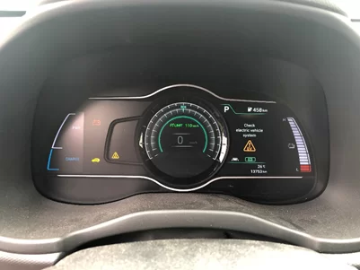

For those interested, some detailed info on my vehicle.
2021 KONA Electric. Manufactured Nov/2020
Dash info:
Software in dash:
Model: OSAE.D1AMC.CA
SW Ver: OSEV20.CAN.SOP.V115.200806
Firmware Ver: OSEV20.CAN.292.200805.MICOM.D
Original Battery info:
HMC P/N 37501-K4054
BMS ROM ID:6980 2020/11/04
Dash warning: Check electric vehicle system
Is this a fluke or sign of a more serious problem with the batteries affecting all Kona electric model years?
