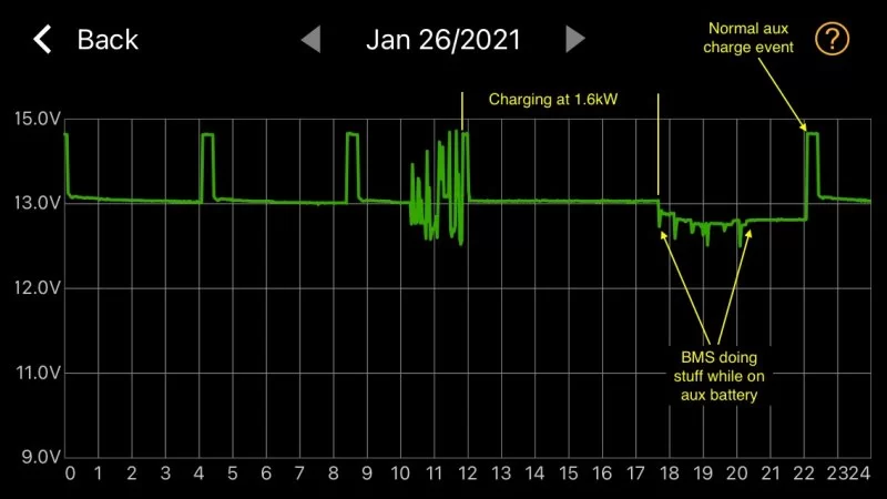

Yes, you're right because that's what the campaign 196 update does every 1/2 or 1 hour for several hours after charging, while drawing needed power off the 12V battery. The problem is that OBD data is likely unavailable.
If the car computers are active and doing things, they should respond to OBD2 requests.

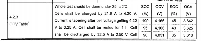

I notice the link to the Queenbattery PDF no longer works (as provided in the leading post in this thread ... maybe lucky to have stumbled on to it before sh@# hit the fan?o_O). However if one is fortunate enough to have acquired it (or has another source for the file), the specs do mention in the 4.23 OCV table electrical specification of a test temperature of 25 +/- 2 degrees C. Also mentioned are resting times between the charge/discharge cycles as well as "OCV at defined SOC is the average of OCV at the same SOC measured by charge and discharge direction".
So far your cell voltage chart seems pretty accurate considering the limited test performed;)
Thanks for the graph and look forward to your further charging results
Just clarifying it says 4.166V for 100%.
Are you referring to this?
If so, that's a reference to the section 4.2.3 which is the original image posted. I saw 4.23 and assumed you meant 4.23V.

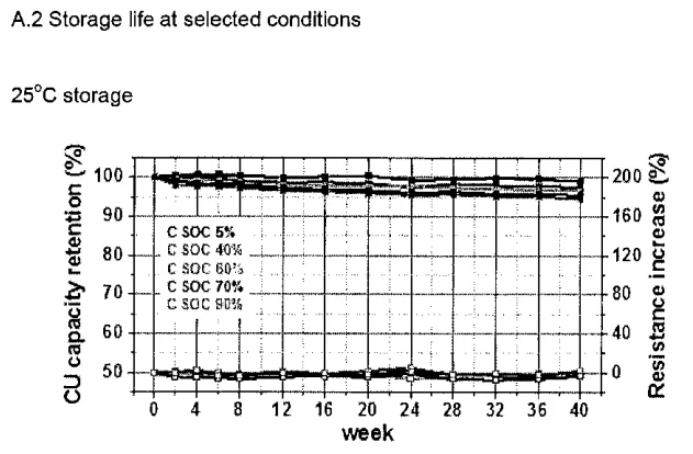

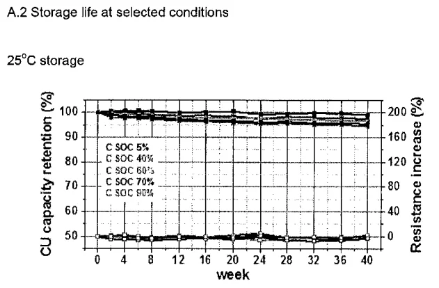

The PDF is still downloadable for me. Interestingly it has cycle life and storage life graphs in the end! Even with worst conditions, the cell appears to last at least ~800 cycles until it has degraded to 80%, which at 400km range translates to 320000km. The storage life graphs are less assuring
Roughly 1-5% degrading per year, depending of SoC. Unfortunately the colors of graphs have been lost, so it's not clear which SoC was the "1%" degrading line, and which one the "5%" one.
The higher the SoC the faster the loss. So storing your battery at 100% for a year will lose about 5%, sounds about right. That's why they say to store at ~40% if you're not going to use it.
