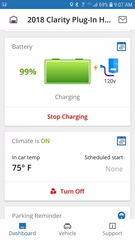

Somebody correct me if I'm wrong, but I think once a L1 charge is complete, you can turn on climate system with either key fob or HondaLink.
Yes, and if car has fully charged but is still plugged in, AFTER you initiate the climate control, the charge will start up again. This has been my experience. Others?
Do you have the charging schedule setup? My experience is with the charging schedule it won't start charging again automatically... I need to start it manually
Yes. Schedule is set. Confirmed the behavior again this morning. Charge had stopped per my set stop time. Charge had reached 94%. I enabled the Climate Control via the key fob and then went to check the car and the charging light had come on. Checked the app and it also confirmed the Climate Control was on and the vehicle was charging.
I'll next try to check if there is any differing behavior if I enable climate control via the app.

I can confirm that initiating preconditioning on a charged clarity with the level 1 charger plugged in does also initiate the charger - confirmed both on the app and via the indicator light by the charge port. I actually tried to test whether it would initiate a charge on a partly depleted battery if you turned charging off first, but didn't catch it until 99%, which changed to 100 as soon as I started preconditioning. Will try that next time. Seems every time someone says there is something you can't do with this car there is a work - around. (This is a base model, by the way - so it has the unadvertised preconditioning...)
