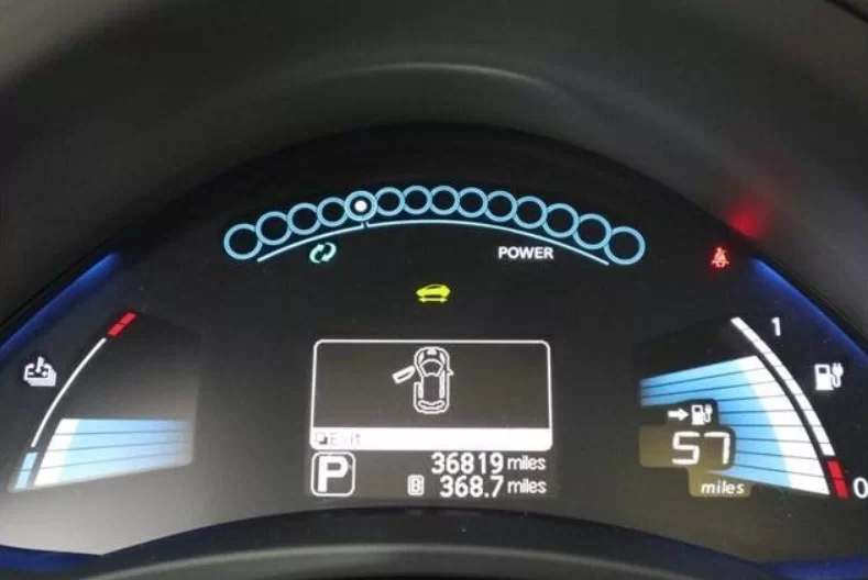

Ok, so, I'm poking around seeing if I can afford a LEAF yet and came across any interesting example of a 2015 for $10,000.
Now, it had a picture of the instrument cluster, but looking at it, I'm not sure which set of bars indicates battery health. Thought it might be the ones on the left, but 4 bars seems kind of low. Anyone know?
I note that even with the mileage showing, it still has all the capacity bars.
