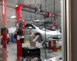

My dealer (AutoFair Nissan, Chelmsford, MA) has replaced a battery. They have two licensed Leaf techs and they're the only guys allowed to touch the car - even for tire rotations, to my chagrin when I just want to get in and out! I talked to one of the front desk guys rather than a Leaf tech about the replacement, and he said they have big yellow safety tape all around the area and no one is allowed inside. He also told me that techs have died swapping batteries, which I hadn't heard before and I deem apocryphal but if it keeps the non-Leaf techs from doing stupid stuff it seems like a good rumor to spread ;-)
Here's a pic of Tom replacing my brake pads/rotors/lines/fluid. You can see they have nice lifts. SpaceCarBrakes.webp
