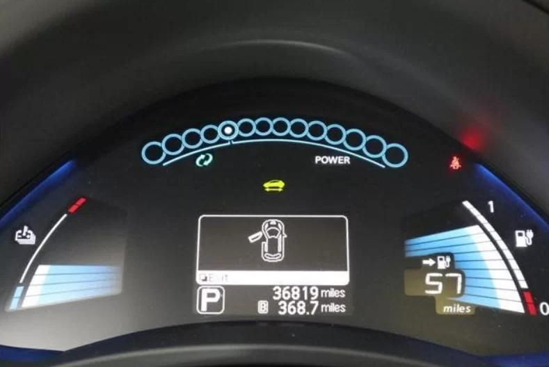

Ok, so, I'm poking around seeing if I can afford a LEAF yet and came across any interesting example of a 2015 for $10,000.
Now, it had a picture of the instrument cluster, but looking at it, I'm not sure which set of bars indicates battery health. Thought it might be the ones on the left, but 4 bars seems kind of low. Anyone know?

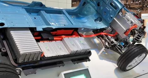

Is it beyond the wit of anyone to produce an aftermarket cooling kit for the leaf?
I think you'd need a lot more than "wit". Waste heat builds up deep inside the battery pack; how could you possibly add something to it that will help with that? You could possibly install a housing around the outside of the pack and some fans for forced-air cooling of the outside of the pack, but at best that's only going to help slightly. For example, the Mitsubishi i-MiEV has forced-air cooling, but I've read it has a problem with battery capacity loss only slightly less bad than the Leaf does. Also, unless you plan on raising the level of the floor or making other extreme modifications, the space available to install a housing around the two parts of the pack is rather restricted, as shown in this diagram:
The real solution is to pump coolant thru tubes all throughout the pack, and that is simply not possible because the Leaf's pack wasn't designed with spaces for such tubes.
The gauge on the left is the battery temperature gauge, so low is good. It's the one on the right that will be of interest. At the moment it's showing only 57 miles of range, so we will hope that's not fully charged! As I understand it, when a Leaf owner says he has "lost bars" he means the maximum charge level shown on that gauge no longer displays all the bars it did when new. That is, the battery's capacity has been reduced.
There are two columns of bars on the right that go 12 bars high. The wide bars that go from blue to white where it shows 87 miles to empty is your current battery capacity. It is pretty high with only the top bar missing. As you drive the car and the battery gets depleted those bars disappear until you charge the car again, just like the Clarity.
The smaller bars along the right edge with a 1 at the top and a 0 at the bottom with the two red bars show the battery health. It has all 12 bars showing, which is perfect. Over time those bars will disappear and they don't ever come back. Our 2013 lost its first bar last year at around 45,000 miles and now only shows 11 bars. So there is nothing wrong with this battery gauge. I hope that all made sense.
Thanks for that, it made total sense. I've got it now. The outer stack of bars on the right of the display. The photo in my post only shows 57 miles, so I gather it's just not charged up all the way.
Correct. If it was, the other stack of bars next to it would be up all the way, too.
Thank you for explaining! :)
It's good to know you can see just by looking at the gauge if the car has lost capacity. Until you explained that, I thought you had to charge it up to see if a Leaf has lost battery capacity, and how much.
