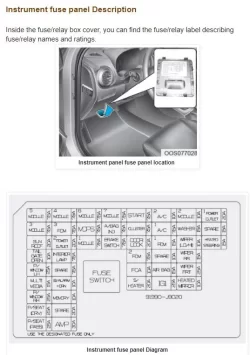

Here is how I fixed my wireless phone charger issue. I have a 2022 Hyundai Kona Limited which is not electric but my comments should apply to electric Kona's.
My wireless phone charger was also not working after I purchased my Kona and the wireless charging option in the "Convenience" folder was not listed. After spending a lot of time researching and playing around I finally got my wireless phone charger to work by removing and re-inserting the 10A fuse for "Module 2" which was in the fuse box inside my car to the lower left of steering wheel (picture attached). This 'Module 2" 10A fuse is located on top row, 2nd fuse from the right. This also got the "Wireless Phone Charging" enable/disable box to show up in the "Convenience" folder.
Please let me know if this helped any of you out.

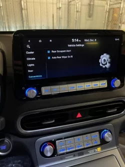

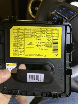

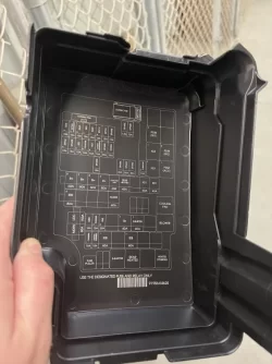

Hey everyone, I recently bought a Kona Ultimate EV 2022 a couple months ago. I've been documenting a couple weird little issues for the next time I bring the car in for service, but a couple days ago I noticed my wireless charger vanish as well. It used to be under "Convenience" but now it's straight up missing. So far I've tried :
In the fuse box below the steering wheel :
1) Flipping the main fuse switch to OFF, wait a moment, start car. Then turn off car again, and switch main fuse back on. No change.
In the fuse box in the hood :
2) I've tried removing and examining the 2 "Charger 10A" fuses - both look good and fine. Reinsert fuse and tested.
I've attached 3 pics of my two fuse covers and a pic of the screen showing the missing charger option.

I saw this so I'm going to try this later. Is there any documentation as to what "Module 2" is?

Just a follow up to my previous post... Hyundai ordered and installed the new wireless charging pad. It's working AND the wireless charging pad ON / OFF option is appearing in my Convenience folder now. Previously it was not. Apparently when the pad isn't functional, it's not recognized on the CAN bus (or something like that) and the firmware removes the wireless charger option from the menus.
Don't know why the charger stopped working the first week of ownership (brand new 2022 Limited), but service dept. told me that it was "broken".
All good now.

'22 Kona Electric SEL here. Can confirm that this method, removing/re-inserting fuses to Module 5 and the two Memory slots, kick started the Wireless Charging AND Digital Key features of which were not working previously. Many thanks, Miro1313!!!
I can also confirm this fix worked. 2022 Kona EV SEL wireless charger stopped working 3 months ago. Had to wait 2 months for dealer appt that I cancelled this morning after reading this and attempting the "fix." Read and double checked fuse diagram. Got fuse puller from engine compartment fuse box. Opened cabin fuse compartment. Pulled #5 then memory #1 then memory #2 fuses in that order then reinstalled in reverse. # 2 memory, # 1 memory then #5. It worked.
Wireless charging is operating normally.

Look at the back of cover. See picture in message 43. Use the fuse remover located in the front fuse box under the hood.
