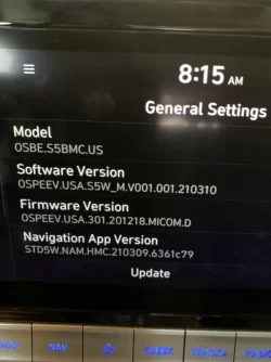

Me either. From reading the manual, it seems that the digital key and wireless charging are connected, and the digital key isn’t available/set up (so says my dealer - can’t get the Bluelink set up either just yet - still working on it. These are good guys, so I’m biding my time for a bit…a couple more weeks…). As for getting to the set up, in the Convenience menu on my display, Wireless Charging isn’t even listed as an option, but I got the Limited model of the 22 Kona (which includes wireless charging). I’ll check which software model is running on my set up tomorrow and post an update.
Update - here’s a pic of the software version:

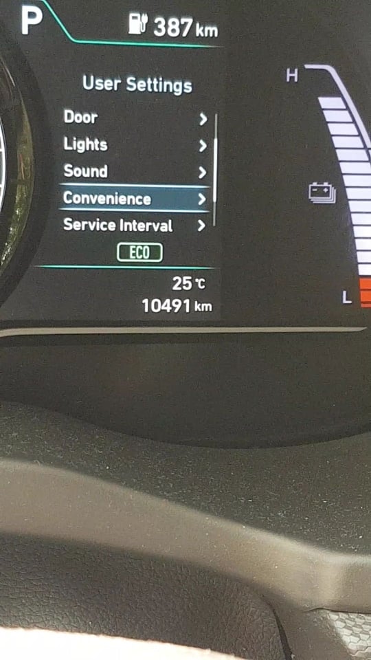

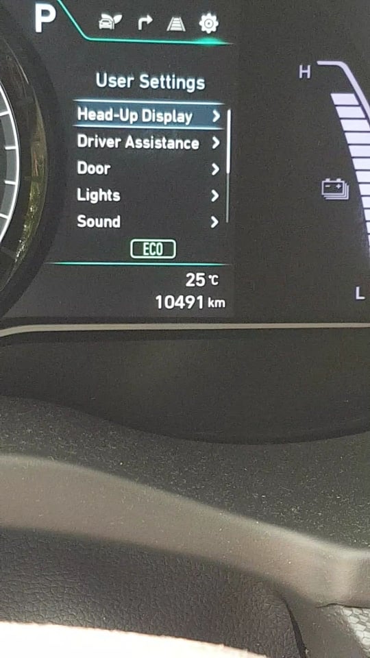

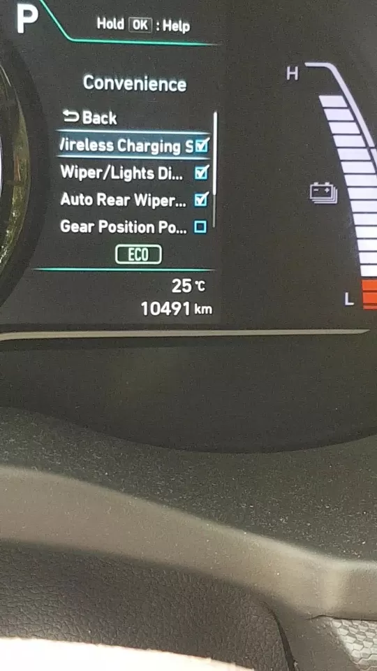

I may have been the fellow who posted about finding and turning on the wireless charging pad.
I found my settings through the steering wheel. Paging through the screens to find user settings.
Hopefully this will help.
Edited to upload more photos.

You have seen posts #11 and #21?
Thor, they absolutely do exist as I posted in #11 with a picture, but maybe your car does not have this feature in your region, or on your model. Surlycat confirms the convenience menu in #21 but does not have the wireless option showing in the region where they live. They have the series II model like you are talking about. On my series II the default setting on is on and the phone charges when it is in place and the orange light glows.
