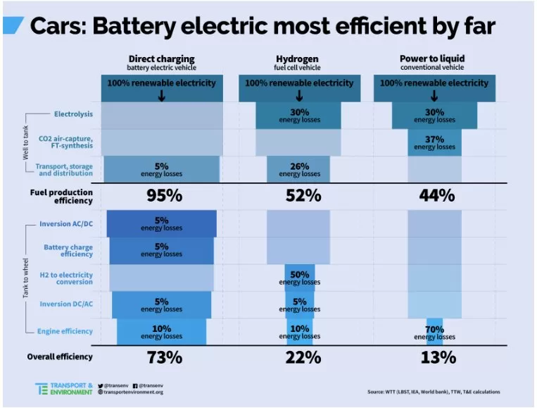

I posted this elsewhere, but here it is again.
uks-transport-environment-says-that-electric-cars-are-the-most-efficient_100626958_l.jpg
From the UK.
