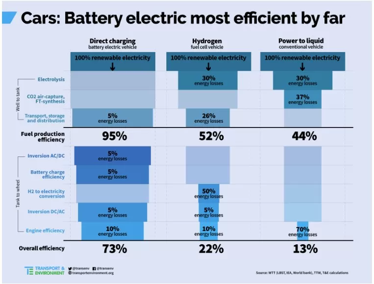

Maybe our case is unique. Our house has solar power. It costs nothing to charge our EV or PHEV. There are studies that show that EV is cleaner than gas or hydrogen. Bottom line: Use EV whenever you can until it runs out.
from the UK-based Transport & Environment
