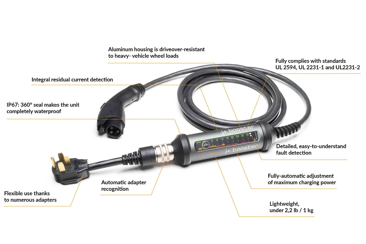

A new EVSE is available, and it looks like a beauty.

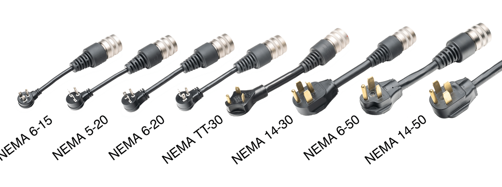

Available now on Amazon it comes only with the 5/15 and 14/50 adaptor. Up to 9.6 kW adjustable manually or automatically. I priced it c/w ALL the adaptors $1366 CDN, not cheap, but worth it for quality and versatility.
I have a trip planned (next year) and will require charging from multiple sources (welding shops (6/50 adaptor), laundry facilities possible (14/30 adaptor), small industrial sites, camping locations etc.

I have emailed back with certification confirmation of a little "c" beside the UL seal, as that is a requirement here in Canada, as well as warranty duration clarification (that should hopefully be confirmed soon)

- As the NEMA 5-15 and 14-50 are the most common outlets those adapters are already included in the standard set. The other adapters will be available through Amazon or directly through us in Q4 of 2022. Price for one piece will be $79.00 for the NEMA 5-20 and 6-20, $119.00 for the TT30 and $129.00 for the NEMA 14-30 and 6-50
- You are correct, the J+ BOOSTER 2 will automatically detect the attached adapter and select the correct amps automatically.

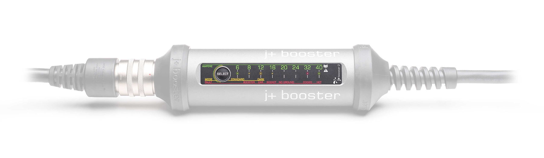

- The J+ BOOSTER 2 will automatically select 80% of the available amperage. With a TT30, you will be charging with 120V, 24 amps = 2,880 Watts as you said. If a breaker in a panel is trigger happy, you can manually further reduce the amperage with the select button on the charger. The J+ BOOSTER 2 will remember that setting until you change the adapter, it then will default to the base setting.
- Note: the 5/20 and 6/20 pictures are reversed
