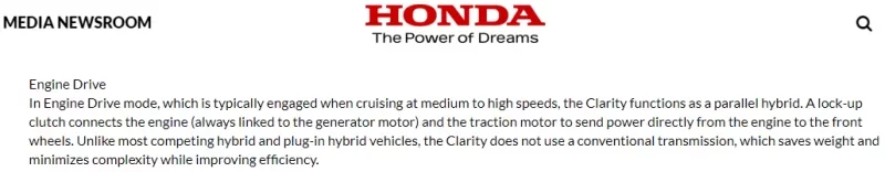

You are theoretically correct, however I am finding conflicting information from Honda about how EDM actually functions. In the press kit, it says that EDM functions as a "parallel hybrid" mode, however according to Honda's own i-MMD explanation videos, EDM uses no battery simultaneously with mechanical propulsion.
https://hondanews.com/en-US/releases/2018-honda-clarity-plug-in-hybrid-press-kit
I'm not sure that I would consider the vehicle shown in the video above to be operating in a "parallel hybrid" mode because the mechanical propulsion is not simultaenously aided by electrical propulsion (and due to Honda's i-MMD design, engine drive mode should theoretically be charging the battery).
Yes, there is conflicting information from Honda.
That is a possible situation, however I am not sure than I understand what point you are making. What you claim here does not negate what I claim in the quote above yours. Both methods are solutions to the issue of how the vehicle might increase power to the wheels when necessary.
Agreed. The point was that there is more than one way for the car to send additional power to the wheels, more RPM’s don’t always equate to more power to the wheels and we have very little control over engine speed.
Up to a point, in EDM, the engine is capable of sending more power directly to the wheels. It takes more power for the car to accelerate. It can accelerate in EDM only, with no assistance from the traction motor, provided that acceleration is very gentle.
