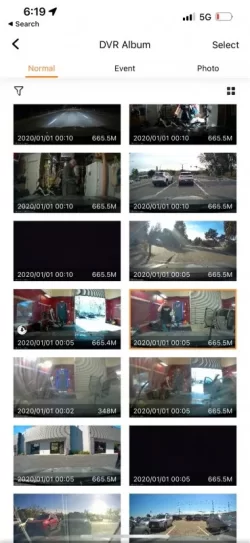

While I highly promoted the dash cam I installed, the Jabriel from AliExpress, I discovered a serious shortcoming with this device. It shoots great video, but it turns out that unless you disconnect from any current WiFi (including CarPlay) and connect directly to the camera, every video clip it shoots resorts to a Jan 2020 datestamp and filename. And while if you want to watch the front-facing video that you see while you're driving, the review of any video footage is useless as it will take you a week to actually find the video you're looking for when someone cuts you off or smashes your SE. It's been over the time allotted for a return, since it took several weeks just to get the thing to work in the first place. I'm going to replace it with the Fitcamx which is on their website and also on Aliexpress, and they've assured me that theirs doesn't have this limitation. The model "B" fits our cars apparently. I'll update when I get it and replace. $150 isn't nothing, but it's also not obscene. I'll take the loss to get something functional and useful. IMG_0648.webp

That's a bummer - Let us know how the Fitcamx works out, I've flagged it as an option when my Mini comes in.
Ok, very happy to report an update! Despite sending back my Jabriel dash cam (they haven't acknowledged receiving it), I have since received and installed what looks like the same (cosmetically) dash cam as made by FitCamX. It has MUCH improved the physical tech (the sides of the case aren't connected by the camera wire), and it does indeed maintain the date/time for file retrieval. Video footage actually looks better (less fish-eye blurring on the sides), and the camera connects and downloads much more quickly to your phone. I went ahead and got the rear camera as well, and thanks to the plush anthracite headliner easily installed the wire to the back trunk. The camera provides 4k video at the front and 1080p to the back, which is great.

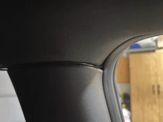

How did you get the wire to back for the rear camera? I have a rear dashcam installed that required going around the top edge by the windows, by going around the b-pillar was near impossible for me. I was hoping I could send the wire straight down the center but it seems there's a lot of "stuff" in the way, even though I opted for no monroof.
I just tucked it under the roof liner. You can pry off the anthracite liner to get it all the way under. IMG_0679.webp
