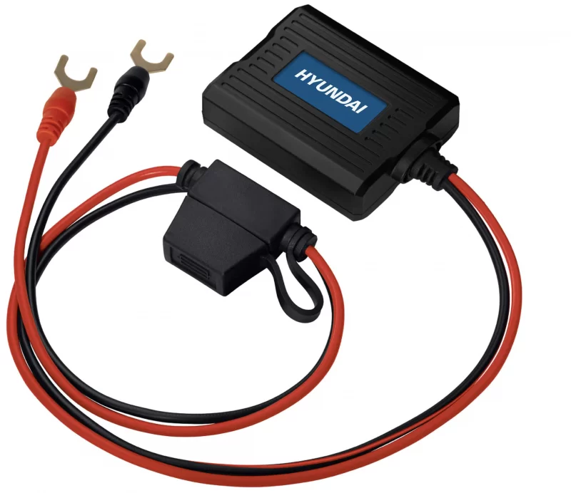

I accidentally stumbled on this little gem, a Hyundai-branded bluetooth battery monitor! Perhaps they've finally realised there's a market for this sort of thing. And it's visibly fused, always a good thing to avoid annoying questions. This will look way more legit in my car when the tech spys it.
It seems to draw more current but can work down to 4V so that's an improvement.
I downloaded the app (iOS) and it doesn't find the BM2 but otherwise the menus look identical enough that it's clearly from the same manufacturer. The specs are not clear about the logging period or memory duration (BM2 is 2 min and 1 month, resp).
Amazingly I can order it locally. It's $79 so I think I will get one to check it out.

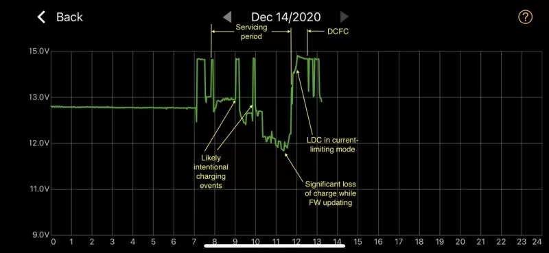

My wife's Kona is getting three (software update) recalls taken care of this Friday morning.
Have folks temporarily removed their BM2 unit from the 12 volt battery prior to bringing the vehicle into the dealership for recall/software updates?
Thanks.
Thanks.
Yup, figured it best that they don't see it.
I did not because I wanted to document the beating my aux battery got while under the knife. No one mentioned its presence and I doubt they even noticed, being as it's wrapped behind the battery.

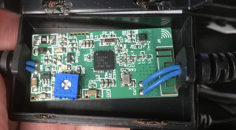

I'm updating this thread with a pic of the BM-2 internals. I bought a second one for my ICE car and it cracked open when I tried to stick it in place with BlueTack.
The main visible chip is a Bluetooth Low Energy modem and there is an LED above the pot that flashes once every time a reading is made. I would expect that a microcontroller is located on the underside but the PCB is glued into the case. Like much of the amazingly-cheap hobby technology we can buy from China these days, this appears to be state of the art.
The pot is for calibrating the voltage to a reference and I was able to adjust that against my DMM to get it perfect. The crap glue used to hold the case together means that the unit is not going to be 100% watertight so best keep these located in a mostly dry area or seal it up with epoxy as I did.
A final note is that when you have more than one BM-2 you can only assign one to the app. You need to upgrade the app (NZ$17) to monitor multiple units.

Hey KiwiME,
Do you intend to use this device with an Apple device or Android? Because if it's with Android I'm afraid you're out of luck - my seller tells me the app has been withdrawn from Google Playstore, though the iOS version is in Apples App Store and I'm told works ok. Being Android only, I am in the process of getting a refund.
My seller was https://iroogroup.com.au, who seem to have a fair bit to do with Hyundai, so if they can't find the app I don't hold out much hope.
If you know of anyone with an apk file or can find one I'd appreciate a heads-up, otherwise I'll go ahead with the refund.

The Hyundai HYBM-2 monitor I bought turned out to be a piece of junk so I returned it many months ago. It doesn't do logging, just instantaneous voltage, hardly any better than using a simple voltmeter.

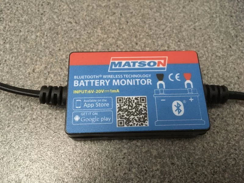

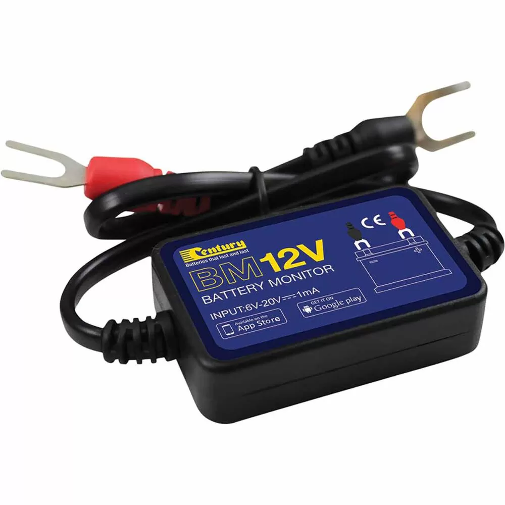

Ignoring the Hyundai device which doesn't seem to be related, I've found three apps so far, Battery Monitor BM2, Century BM12V and Matson.
I have one hardware device marked BM2 the another marked Matson, was sold at SuperCheap a few months back. The one currently sold at SuperCheap is marked Century BM12V and looks similar but not identical.
I've been using the BM2 app on iOS and Android for over a year and it works with the BM2 and Matson devices, but in my experience from some months back in iOS it loses history if both are accessed over time. It was also a pain to select the device if they were both local, it picks the first on in the list. I didn't try this in Android.
But there is a paid version called BM3 (Android only) by the same developer, indicated as being multi-battery but it was a bit too pricey for an experiment so I haven't bothered, nevermind the terrible reviews. I haven't tried multiple devices on the free app recently, noting that it has been updated frequently, last time only 2 months ago, it's now at 2.19.2 (iOS), 3.3.1 (Android).
The Century BM12V app (1.2.1) looks exactly like the BM2 app but hasn't been updated and looks abandoned. I'm deleting that one.

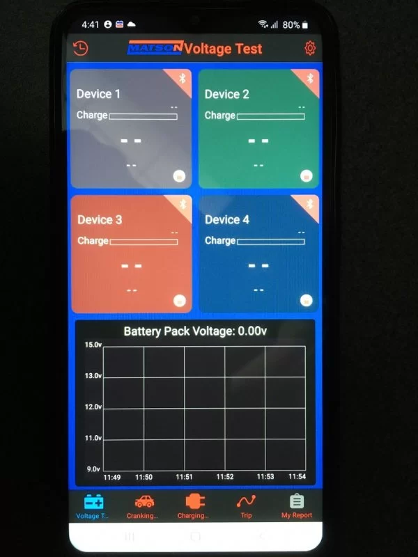

The Matson app (see pic below) looks totally different, handles four devices but doesn't oddly won't connect with either of my 2 devices, iOS or Android. The QR code on the Matson device amusingly goes to the BM2 app. The developer of this app is the same as the Century BM12V app. I'm deleting the Matson app.

So far, my 2 bm12v installs (android) have performed as expected, including reloading the last data set previously viewed...
