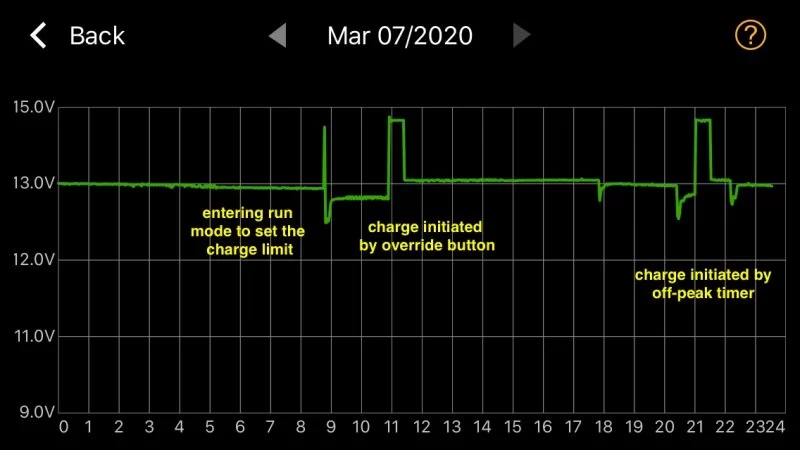

... I turned the car on for a little while, and the voltage shot up to 14.3V (charging). After turning the car off, the battery dropped to 12.15V, and has slowly crept back up to the 12.57V over the last hour.
The voltage tends to be somewhat elastic after either charge or discharge but 12.15 is a bit low. You can see here where I entered run mode for 30 sec to change the charge limit setting. The draw on shutdown does take a bit off the top and you can see how long it took to recover in the next event when an overridden-timer traction battery charge started. The glitch at 1800 is when I opened the rear hatch cover.

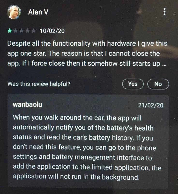

I use both types of phone for this and the Android used about 850 KB data but I did have location enabled, now disabled. I did find this comment from the developer in the app reviews:

I did find this comment from the developer in the app reviews: ...
Yes, the developer replied over and over that we can put BM2 on the list in Settings - Battery that prohibits it from running in background. But that's a bunch of BM. I did that, but I back out of the app using back-arrow and the notification remains that it's still running in background, even on the lock screen.
When I force the app to stop, that finally kills it. But a few hours later it is back running again.

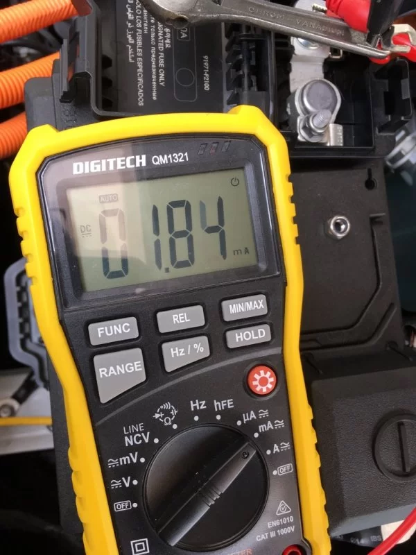

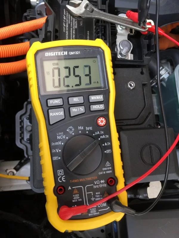

Well, why not, nothing else to do ... 1.8 mA with no connection or 2.5 when monitoring with the app. When initially connecting it goes up to 3.5 for a few seconds.
Thanks, @KiwiME. So power consumption a bit more than 1 Ah / month, which is down in the noise with everything else the car does.

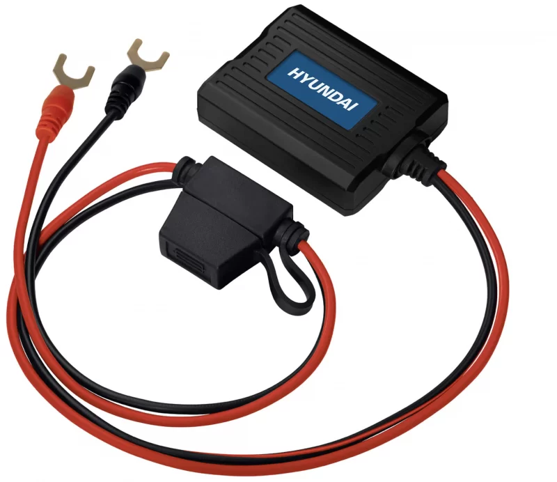

I accidentally stumbled on this little gem, a Hyundai-branded bluetooth battery monitor! Perhaps they've finally realised there's a market for this sort of thing. And it's visibly fused, always a good thing to avoid annoying questions. This will look way more legit in my car when the tech spys it.
It seems to draw more current but can work down to 4V so that's an improvement.
I downloaded the app (iOS) and it doesn't find the BM2 but otherwise the menus look identical enough that it's clearly from the same manufacturer. The specs are not clear about the logging period or memory duration (BM2 is 2 min and 1 month, resp).
Amazingly I can order it locally. It's $79 so I think I will get one to check it out.
